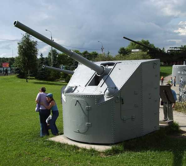

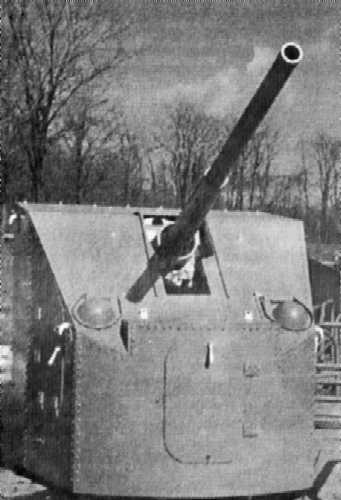

In 1944 a single turret mount MK-85 was created by TsKB-34.  The turret was designed for use on the River gunboats, but was also used on some of the Pr.30bis destroyers.  The mount was accepted into service in 1946 and was in production from 1946 to the mid 1950s.  The turret was similar in construction to the contemporary tank turrets and used the ZIS-S-53 tank gun (similar to the 90-K gun) but modified for high angle firing.

85 mm/52 single mounting now at Moscow Victory Park in Russia
