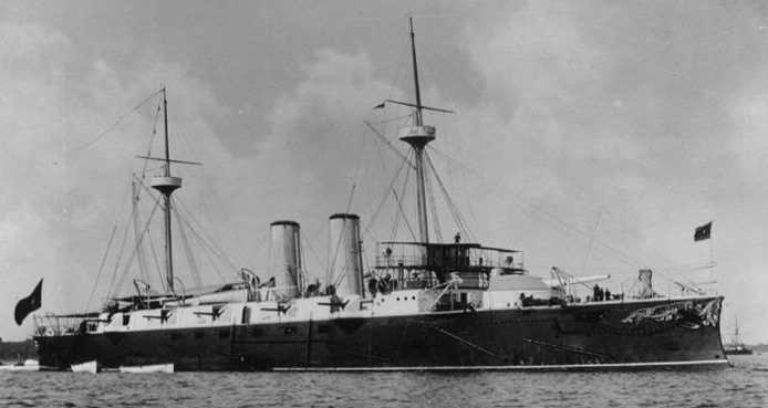

Based upon a 27.4 cm (10.78") Canet gun design, these guns were manufactured by Hontoria in Spain under French license.  Two of these guns were mounted on the battleship Pelayo, one on each beam.  Later ships had one gun on the bow and one on the stern.  All were mounted in barbettes.
Armored Cruiser Infanta Maria Teresa around 1895
U.S. Naval Historical Center Photograph # NH 88603
