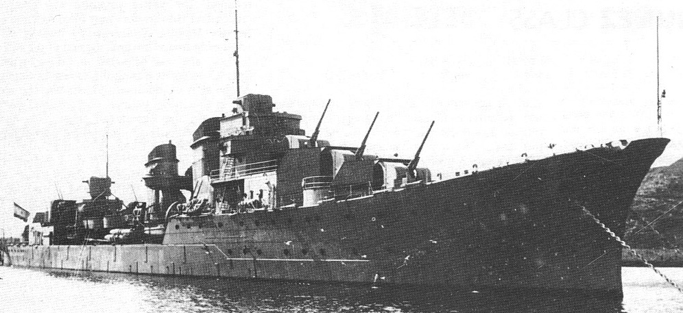

A Vickers-Armstrong design used as anti-aircraft guns on the Canaris and rebuilt Mendez Nunez cruisers.  Of built-up construction and used a semi-automatic breech-block.
Heavy Cruiser Canaris
Armada Española Photograph

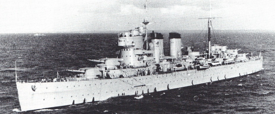

Mendez Nunez as AA cruiser

2) Mendez Nunez was originally equipped with six 6"/45 (15.2 cm) guns.  She was rebuilt and rearmed as an AA-cruiser during 1944.
