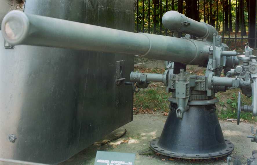

The Model 1936 was a wet-mount used on Polish submarines while the Model 1940 was an AA gun used on Swedish minesweepers.
10.5 cm/41 Model 1936 from Polish Submarine Sep now at the Polish Army Museum, Warsaw
