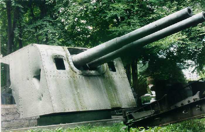

Twin 12 cm/50 Model 1934/1936 from Polish Minelayer Gryf now at the Exposition of Navy Museum, Gdynia

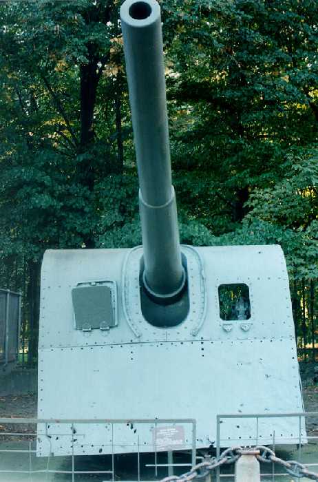

Single 12 cm/50 Model 1934/1936 from Polish Minelayer Gryf now at the Polish Army Museum, Warsaw
