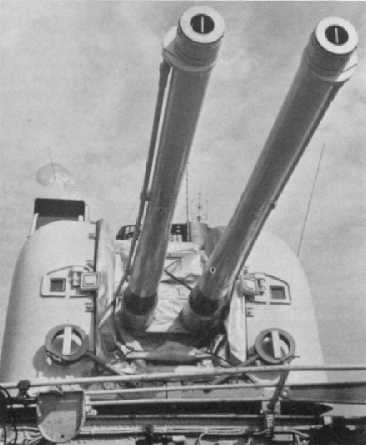

12 cm on Netherlands Tromp Class Frigate

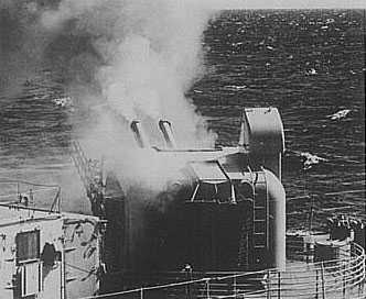

12 cm mounting on RSN Halland

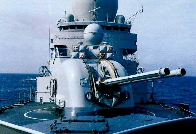

Forward 12 cm mounting on RSN Halland

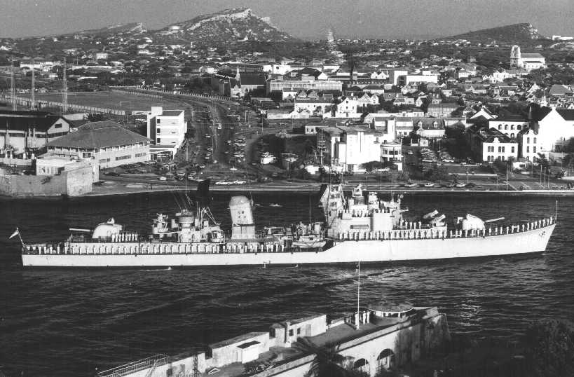

HNLMS Amsterdam arriving at Willemstad, Curacao in 1977
Photograph courtesy of Sjef Pijls, who was her deputy weapon engineering officer in 1977
