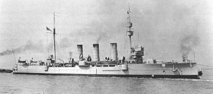

An early Bofors design.  Interesting in that these guns were mounted in enclosed gunhouses, unusual in an age where most cruiser guns were in single open shields.  Apparently, from examining photographs, they were also individually sleeved.
Armored Cruiser Fylgia
