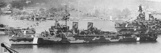

A Bofors built-up design using an ogival screw breech used only on the seaplane carrier Gotland.  The twin turrets on Gotland were electrically powered with hydraulic drive gears and the guns were individually sleeved.
For financial reasons, two of these guns were mounted in casemates.
Seaplane Cruiser Gotland
Note that the 15.2 cm guns were in both turrets and casemates
