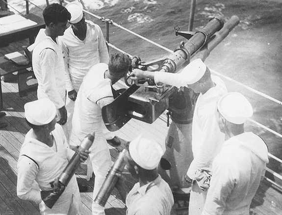

3"/23 (7.62 cm) Mark 7 (?) on board USS Isabel (PY-10) about 1933
Note the heavy recoil cylinder, the protective breech guard and that this is not a semi-automatic design
