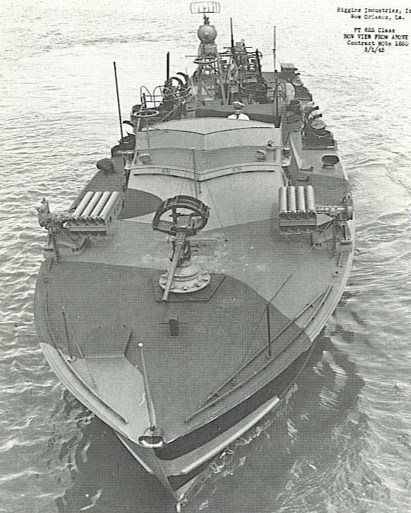

37 mm on bow of PT-631
Distinctive "arched" magazine was designed to fit into the nose of P-39 aircraft
US Navy Photograph taken in early 1945
