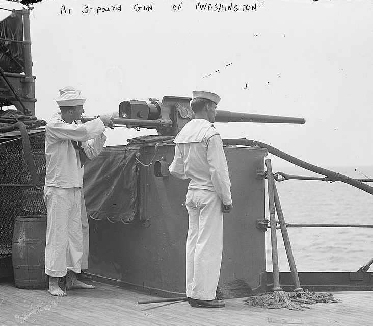

3-pdr gun on USS Washington ACR-11
Note bare-foot sailor
Bain News Service Photograph
Library of Congress Photograph ID LC-DIG-ggbain-09052
