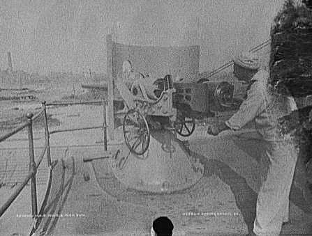

Early 4"/40 (10.2 cm) gun on USS Iowa B-4
Library of Congress Photograph ID LC-D4-20440
