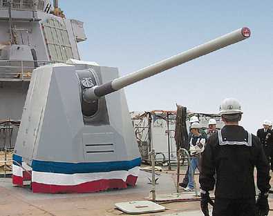

5"/62 (12.7 cm) Mark 45 Mod 4 on USS Winston Churchill DDG-81
Photograph copyrighted by United Defense
