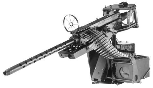

The feed system for 600 round magazines has been modified to reduce the air stream problem and FN Herstal has added a flash suppressor, as can be seen below in the second photograph.
0.50" (12.7 mm) M3M FN Herstal MG
U.S. Marine Corps Photograph

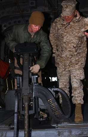

M3M mounted on the ramp of a CH-53E Super Stallion
U.S. Marine Corps Photograph taken by Sgt. Matthew B. Roberson

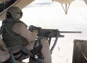

Cpl. Christopher C. Turner, CH-53E crew chief and GAU-21 Instructor, gives a gun mount operation and safety brief to Gen. Michael W. Hagee, Commandant of the Marine Corps, in December 2004
USMC Photograph ID # 2004121515430 taken by Sgt. Nathan K. LaForte

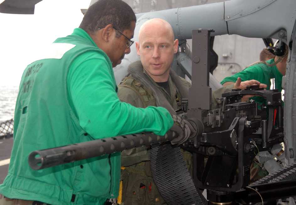

M3M being mounted on an MH-60S Sea Hawk helicopter in November 2009
U.S. Navy Photograph No. 091119-N-7058E-176
