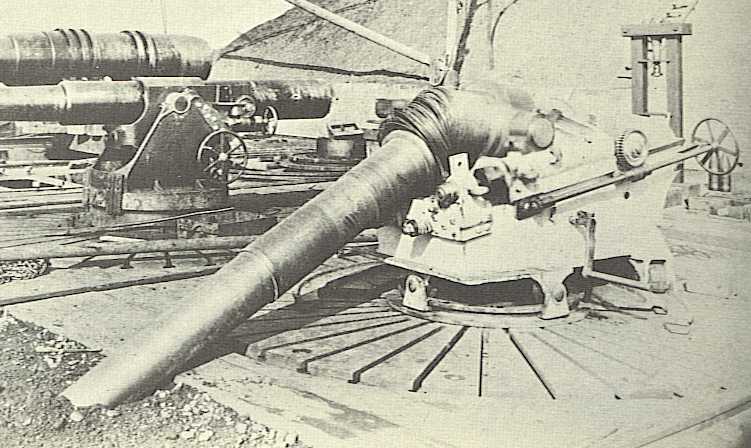

6"/50 (15.2 cm) Mark 11
This appears to be the Mark 11 wire-wound Vickers gun.  The gun pictured burst after firing 45 rounds sometime around 1910.
A wire-wound gun built by Vickers Sons & Maxim Co., no details survive.  May have been purchased to evaluate British construction methods and gun performance.  Vickers serial number 1070a, USN serial number 524.
