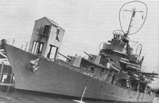

USS Erie PG-50 in September 1942
Circled areas represent recent changes, in this case a new Mark 3 Radar atop her Mark 35 director, new radio antennas and bridge modifications
