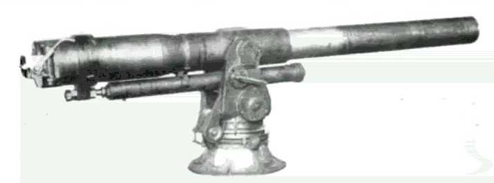

The 8"/23 (20.3 cm) Mark 7 was an ASW Howitzer that could be used in place of the standard 4"/50 (10.2 cm) destroyer gun.  Not known how successful this weapon was, but none survived to World War II.  Made from a single alloy-steel forging.

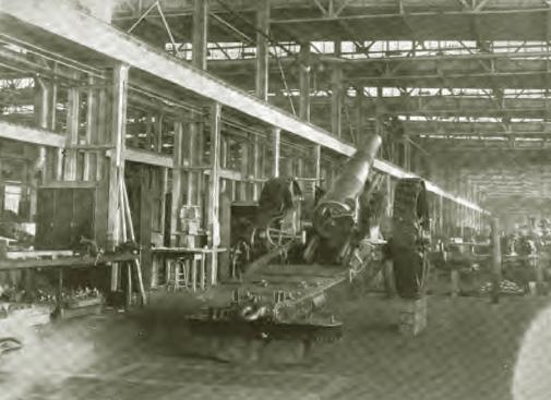

The USN 8"/15 (20.3 cm) Mark 8 was the Vickers 8" (20.3 cm) BL Mark 6 Model 1917 land howitzer that was issued to the US Marine Corps during World War I.  Weight with breech block was 6,552 lbs. (2,972 kg).

8"/23 (20.3 cm) Mark 7 Howitzer
Vickers 8"/15 (20.3 cm) Mark 8 Howitzer
Designation 8"/23 (20.3 cm) Mark 7
Ship Class Used On Flush-deck destroyers of World War I
Date Of Design N/A
Date In Service 1918 (?)
Gun Weight 5,560 lbs. (2,522 kg) with breech block
Gun Length oa 190 in (4.826 m)
Bore Length 184 in (4.674 m)
Twist Uniform RH 1 in 15
Rate Of Fire 3 - 4 rounds per minute
Projectile Types and Weights HE - 285 lbs. (129.3 kg)
Bursting Charge HE - 70 lbs. (31.8 kg)
Muzzle Velocity 650 fps (198 mps)
Note:  This weapon may have later used the standard 8" (20.3 cm) 260 lbs. (118 kg) shell.
Elevation With 285 lbs. (129.3 kg) HE Shell
Range @ 20.8 degrees 2,600 yards (2,380 m)

Note:  This mounting was interchangeable with the standard 4"/50 (10.2 cm) Mark 12 mounting used on the flush-deck destroyers of World War I.
