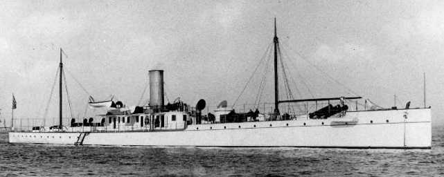

The US Navy also expressed interest in these guns and in June 1890 the well-known 930 ton (944 mt) Vesuvius "dynamite gun cruiser" was commissioned.  Her armament consisted of three 15" (38.1 cm) pneumatic guns in a fixed installation firing forward with an outfit of ten shells per gun.  Although modestly successful, these guns were found to have limited usefulness for naval service.  As the installation could not be trained, the entire ship needed to be pointed at the target.  Elevation was also fixed, but the range could be changed by adjusting the air pressure used.  However, the maximum range of these guns was only about one and a half nautical miles, too short for even the limited battle ranges of the time.

"Dynamite Cruiser" Vesuvius soon after she was commissioned
The muzzles of her three pneumatic guns can be seen on the bow
U.S. Naval Historical Center Photograph NH # 69211
