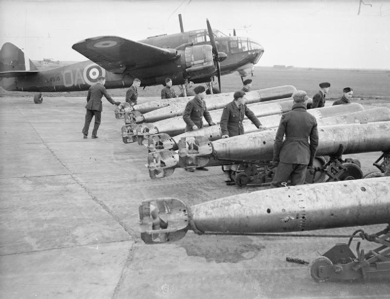

Torpedoes and Beaufort L4516 of No 22 Squadron at North Coates in early December 1940
Note the ropes to keep torpedoes from falling off the trolleys
IWM Photograph 1854

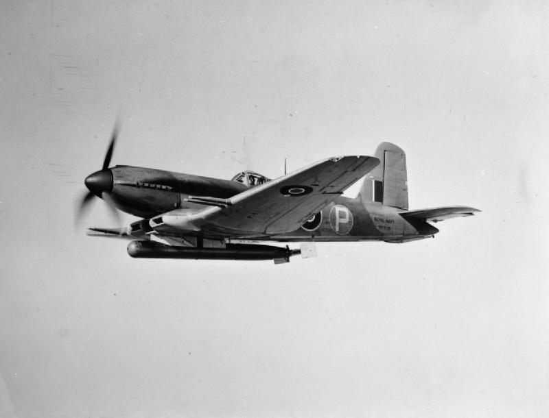

Prototype Blackburn Firebrand with a torpedo
Note the unusual torpedo tail assembly, apparently needed to clear the aircraft fuselage.  This design was not used on production aircraft.
IWM photograph MH 4526

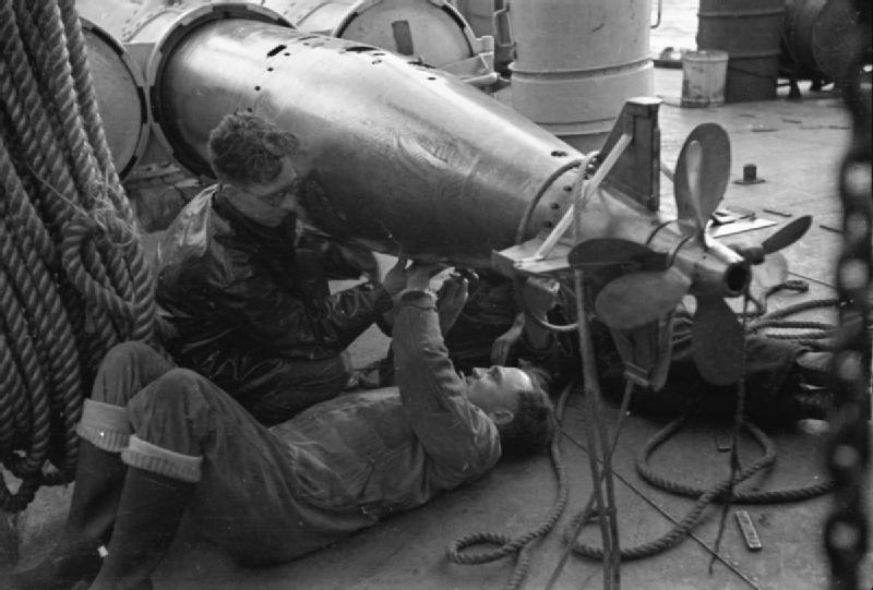

Maintaining a Mark IX torpedo
IWM photograph A 1854
