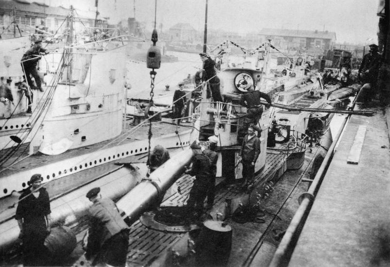

45 cm (17.7") C/06 and C/06 D
Loading torpedoes aboard a U-Boat of the German Flanders Flotilla at Bruges.
IWM Photograph HU 107214
Ship Class Used On U-boats, starting with U-3
