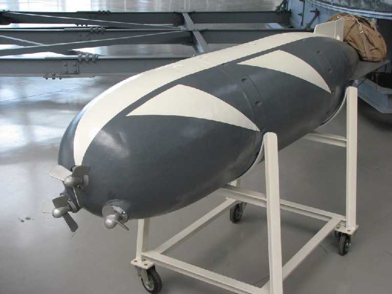

50 cm (19.7") W 120/500 x 2.6
Torpedo on display at Museo Storico dell’Aeronautica Militare (Italian Air Force Museum) at Vigna di Valle
Photograph copyrighted by Geoff Chennells

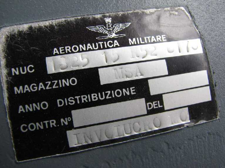

ID tag on above torpedo
Ship Class Used On Aircraft
Date Of Design N/A
Date In Service N/A
Weight 772 lbs. (350 kg)
Overall Length 8 ft. 6.5 in (2.600 m)
Explosive Charge 265 lbs. (120 kg)
Range / Speed 16,400 yards (15,000 m) / 13.5 knots (initial) down to 3.9 knots (end)
Power Battery
Notes:  Fiume (Whitehead) Torpedo.  This was a short parachute-dropped torpedo that ran in circles, spirals and curves.  Dropping conditions were about 150 knots from 200 to 600 feet (60 to 180 m).  Lacked depth control and lateral control was said to be "primative" resulting in runs that varied considerably in depth and were irregular spirals and curves.  This torpedo was also used by the Germans and designated "LT350" type.
