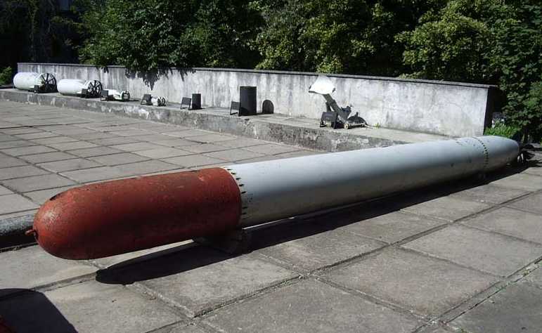

533 mm (21") 53-39
533mm "53-39" Pattern 1939 Torpedo
Now at the Great Patriotic War Museum, Minsk, Belarus
Ship Class Used On Large surface combatants, MTBs and submarines
Date Of Design 1939
Date In Service 1941
Weight 3,924 lbs. (1,780 kg)
Overall Length 24.61 feet (7.5 m)
Explosive Charge 698.9 lbs. (317 kg)
Range / Speed 4,370 yards (4,000 m) / 51.0 knots
8,750 yards (8,000 m) / 39.0 knots
10,940 yards (10,000 m) / 34.0 knots
Power Wet-heater
Notes:  Modernization of the 53-38 torpedo with main goal to increase the speed without sacrificing the range.
