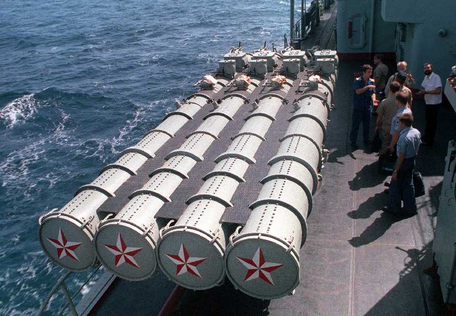

Quad torpedo tubes aboard Admiral Vinogradov (BPD-554) in 1992
U.S. Navy Photograph No. DN-SC-93-04775
