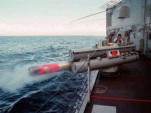

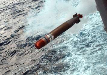

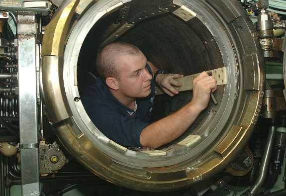

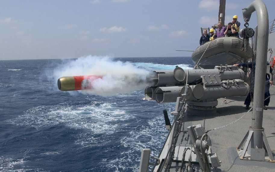

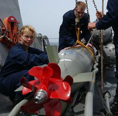

12.75" (32.4 cm) Mark 46
 Removing a Mark 46 Mod 5A torpedo out of a launching tube during a periodic local firing test aboard guided missile destroyer USS Mustin DDG-89 in April 2005
Note the contra-rotating propellers
U.S. Navy Photograph 050418-N-5526M-018

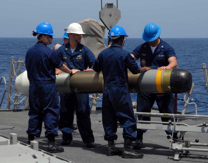

Firing a practice torpedo from the Mark 32 Mod 15 Torpedo Launcher aboard guided missile destroyer USS Mustin DDG-89 in April 2007
This torpedo launcher holds three Mark 46 Mod 5A torpedoes.  Note the cover lids strapped to the side of the launcher.
U.S. Navy Photograph 070412-N-9851B-007
Launching a Mark 46 from a Surface Warship
Firing a Mark 46 from HMAS Adelaide
Australian Navy Photograph wpn2000408-15

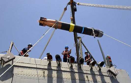

Performing preventative maintenance on USS Porter DDG-78 in November 2007
US Navy Photograph No. 071119-N-4014G-022

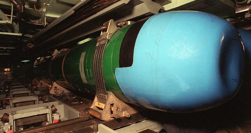

Performing maintenance on a 21" (53.3 cm) torpedo tube aboard USS Norfolk SSN-714 in January 2006
U.S. Navy Photograph No. 060117-N-5863B-129

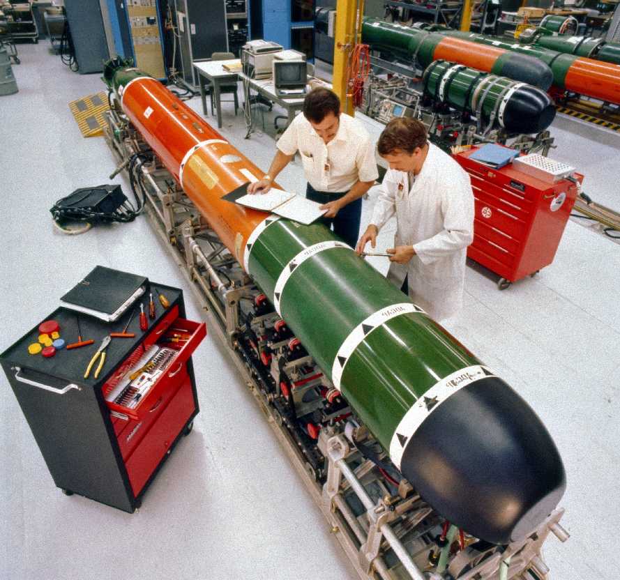

Keyport Technicians working on a Mark 48 in early 1982
U.S. Navy Photograph No. DN-SC-86-00553

12.75" (32.4 cm) Mark 50 Barracuda
Mark 50 torpedo aboard USS Bulkeley DDG-84 in June 2004
U.S. Navy Photograph 040623-N-5319A-001

12.75" (32.4 cm) "MAKO" Mark 54
Mark 54 Torpedo aboard USS Ross DDG-71 in March 2008
U.S. Navy Photograph 080330-N-0924R-029
