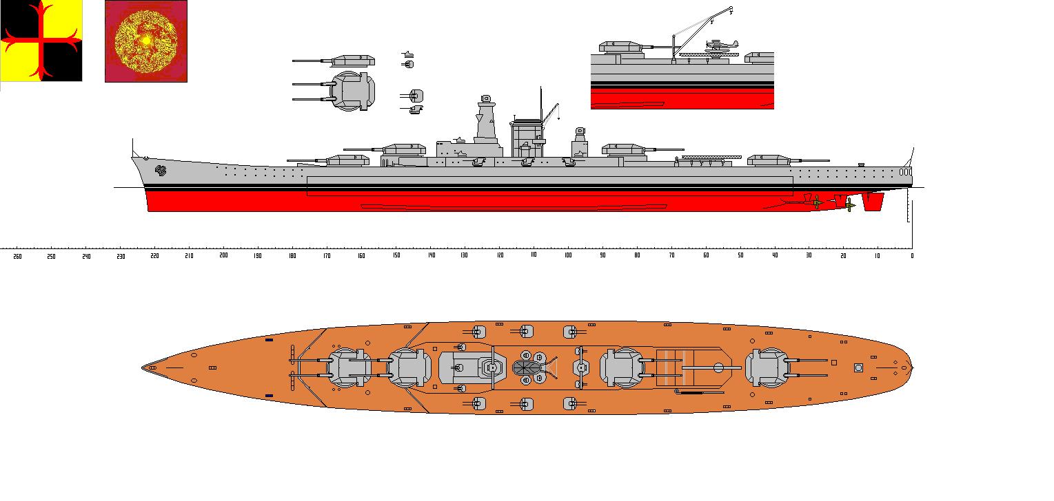

Enter ship name, Enter country Enter ship type laid down 1930Displacement:        19,398 t light; 20,705 t standard; 23,693 t normal; 26,083 t full loadDimensions: Length (overall / waterline) x beam x draught (normal/deep)        (741.48 ft / 731.63 ft) x 88.58 ft x (25.59 / 27.48 ft)        (226.00 m / 223.00 m) x 27.00 m  x (7.80 / 8.38 m)Armament:      12 - 9.45" / 240 mm 55.0 cal guns - 455.29lbs / 206.51kg shells, 200 per gun          Breech loading guns in turret on barbette mounts, 1930 Model          4 x Triple mounts on centreline ends, evenly spread                2 raised mounts - superfiring      12 - 5.04" / 128 mm 50.0 cal guns - 67.74lbs / 30.73kg shells, 500 per gun          Dual purpose guns in deck mounts, 1930 Model          6 x 2-gun mounts on sides, evenly spread      Weight of broadside 6,276 lbs / 2,847 kgArmour:   - Belts:                Width (max)        Length (avg)                Height (avg)        Main:        5.91" / 150 mm        492.13 ft / 150.00 m                16.40 ft / 5.00 m        Ends:        3.15" / 80 mm        180.45 ft / 55.00 m                16.40 ft / 5.00 m          59.06 ft / 18.00 m Unarmoured ends        Upper:        3.15" / 80 mm        492.13 ft / 150.00 m                6.56 ft / 2.00 m          Main Belt covers 103% of normal length          Main Belt inclined -15.00 degrees (positive = in)   - Torpedo Bulkhead - Strengthened structural bulkheads:                3.94" / 100 mm        524.93 ft / 160.00 m                27.89 ft / 8.50 m        Beam between torpedo bulkheads 68.90 ft / 21.00 m   - Gun armour:        Face (max)        Other gunhouse (avg)        Barbette/hoist (max)        Main:        9.84" / 250 mm        3.94" / 100 mm                7.09" / 180 mm        2nd:        1.97" / 50 mm        1.97" / 50 mm                      -   - Protected deck - multiple decks:        For and Aft decks: 3.94" / 100 mm   - Conning towers: Forward 9.06" / 230 mm, Aft 0.00" / 0 mmMachinery:        Oil fired boilers, steam turbines,         Geared drive, 3 shafts, 120,000 shp / 89,520 Kw = 33.19 kts        Range 9,000nm at 19.00 kts        Bunker at max displacement = 5,379 tonsComplement:        954 - 1,241Cost:        £6.814 million / $27.256 millionDistribution of weights at normal displacement:        Armament: 1,655 tons, 7.0%           - Guns: 1,655 tons, 7.0%        Armour: 7,889 tons, 33.3%           - Belts: 2,491 tons, 10.5%           - Torpedo bulkhead: 2,132 tons, 9.0%           - Armament: 1,012 tons, 4.3%           - Armour Deck: 2,114 tons, 8.9%           - Conning Tower: 140 tons, 0.6%        Machinery: 3,636 tons, 15.3%        Hull, fittings & equipment: 6,218 tons, 26.2%        Fuel, ammunition & stores: 4,295 tons, 18.1%        Miscellaneous weights: 0 tons, 0.0%Overall survivability and seakeeping ability:        Survivability (Non-critical penetrating hits needed to sink ship):          32,436 lbs / 14,713 Kg = 76.9 x 9.4 " / 240 mm shells or 5.8 torpedoes        Stability (Unstable if below 1.00): 1.11        Metacentric height 5.1 ft / 1.5 m        Roll period: 16.6 seconds        Steadiness        - As gun platform (Average = 50 %): 81 %                        - Recoil effect (Restricted arc if above 1.00): 0.48        Seaboat quality  (Average = 1.00): 1.08Hull form characteristics:        Hull has a flush deck,          a normal bow and small transom stern        Block coefficient (normal/deep): 0.500 / 0.513        Length to Beam Ratio: 8.26 : 1        'Natural speed' for length: 29.28 kts        Power going to wave formation at top speed: 53 %        Trim (Max stability = 0, Max steadiness = 100): 75        Bow angle (Positive = bow angles forward): 20.00 degrees        Stern overhang: 0.30 ft / 0.09 m        Freeboard (% = length of deck as a percentage of waterline length):                                Fore end,         Aft end           - Forecastle:        20.00%,  26.25 ft / 8.00 m,  22.97 ft / 7.00 m           - Forward deck:        30.00%,  22.97 ft / 7.00 m,  18.04 ft / 5.50 m           - Aft deck:        35.00%,  18.04 ft / 5.50 m,  18.04 ft / 5.50 m           - Quarter deck:        15.00%,  18.04 ft / 5.50 m,  18.04 ft / 5.50 m           - Average freeboard:                20.03 ft / 6.11 m        Ship tends to be wet forwardShip space, strength and comments:        Space        - Hull below water (magazines/engines, low = better): 77.7%                - Above water (accommodation/working, high = better): 169.3%        Waterplane Area: 44,215 Square feet or 4,108 Square metres        Displacement factor (Displacement / loading): 110%        Structure weight / hull surface area: 150 lbs/sq ft or 731 Kg/sq metre        Hull strength (Relative):                - Cross-sectional: 1.00                - Longitudinal: 1.08                - Overall: 1.00        Excellent machinery, storage, compartmentation space        Excellent accommodation and workspace room        Ship has slow, easy roll, a good, steady gun platform
换炮的方案
Enter ship name, Enter country Enter ship type laid down 1930Displacement:        19,600 t light; 20,948 t standard; 23,957 t normal; 26,365 t full loadDimensions: Length (overall / waterline) x beam x draught (normal/deep)        (741.43 ft / 731.63 ft) x 88.58 ft x (25.72 / 27.62 ft)        (225.99 m / 223.00 m) x 27.00 m  x (7.84 / 8.42 m)Armament:      8 - 11.02" / 283 mm 54.5 cal guns - 727.53 lbs / 330.00 kg shells, 200 per gun          Breech loading guns in turret on barbette mounts, 1930 Model          4 x Twin mounts on centreline ends, evenly spread                2 raised mounts - superfiring      12 - 5.04" / 128 mm 50.0 cal guns - 67.75lbs / 30.73kg shells, 500 per gun          Dual purpose guns in deck mounts, 1930 Model          6 x 2-gun mounts on sides, evenly spread      Weight of broadside 6,597 lbs / 2,992 kgArmour:   - Belts:                Width (max)        Length (avg)                Height (avg)        Main:        5.91" / 150 mm        492.13 ft / 150.00 m                16.40 ft / 5.00 m        Ends:        3.15" / 80 mm        180.45 ft / 55.00 m                16.40 ft / 5.00 m          59.06 ft / 18.00 m Unarmoured ends        Upper:        3.15" / 80 mm        492.13 ft / 150.00 m                6.56 ft / 2.00 m          Main Belt covers 103% of normal length          Main Belt inclined -15.00 degrees (positive = in)   - Torpedo Bulkhead - Strengthened structural bulkheads:                3.94" / 100 mm        524.93 ft / 160.00 m                27.89 ft / 8.50 m        Beam between torpedo bulkheads 68.90 ft / 21.00 m   - Gun armour:        Face (max)        Other gunhouse (avg)        Barbette/hoist (max)        Main:        9.84" / 250 mm        3.94" / 100 mm                7.09" / 180 mm        2nd:        1.97" / 50 mm        1.97" / 50 mm                      -   - Protected deck - multiple decks:        For and Aft decks: 3.94" / 100 mm   - Conning towers: Forward 9.06" / 230 mm, Aft 0.00" / 0 mmMachinery:        Oil fired boilers, steam turbines,         Geared drive, 3 shafts, 120,000 shp / 89,520 Kw = 32.89 kts        Range 9,000nm at 19.00 kts        Bunker at max displacement = 5,417 tonsComplement:        962 - 1,251Cost:        £6.969 million / $27.876 millionDistribution of weights at normal displacement:        Armament: 1,454 tons, 6.1%           - Guns: 1,454 tons, 6.1%        Armour: 7,731 tons, 32.3%           - Belts: 2,491 tons, 10.4%           - Torpedo bulkhead: 2,007 tons, 8.4%           - Armament: 971 tons, 4.1%           - Armour Deck: 2,120 tons, 8.8%           - Conning Tower: 141 tons, 0.6%        Machinery: 3,636 tons, 15.2%        Hull, fittings & equipment: 6,780 tons, 28.3%        Fuel, ammunition & stores: 4,357 tons, 18.2%        Miscellaneous weights: 0 tons, 0.0%Overall survivability and seakeeping ability:        Survivability (Non-critical penetrating hits needed to sink ship):          32,404 lbs / 14,698 Kg = 48.9 x 11.0 " / 280 mm shells or 5.9 torpedoes        Stability (Unstable if below 1.00): 1.11        Metacentric height 5.1 ft / 1.6 m        Roll period: 16.9 seconds        Steadiness        - As gun platform (Average = 50 %): 80 %                        - Recoil effect (Restricted arc if above 1.00): 0.50        Seaboat quality  (Average = 1.00): 1.07Hull form characteristics:        Hull has a flush deck,          a normal bow and small transom stern        Block coefficient (normal/deep): 0.503 / 0.515        Length to Beam Ratio: 8.26 : 1        'Natural speed' for length: 29.27 kts        Power going to wave formation at top speed: 53 %        Trim (Max stability = 0, Max steadiness = 100): 75        Bow angle (Positive = bow angles forward): 20.00 degrees        Stern overhang: 0.30 ft / 0.09 m        Freeboard (% = length of deck as a percentage of waterline length):                                Fore end,         Aft end           - Forecastle:        20.00%,  26.12 ft / 7.96 m,  22.83 ft / 6.96 m           - Forward deck:        30.00%,  22.83 ft / 6.96 m,  17.91 ft / 5.46 m           - Aft deck:        35.00%,  17.91 ft / 5.46 m,  17.91 ft / 5.46 m           - Quarter deck:        15.00%,  17.91 ft / 5.46 m,  17.91 ft / 5.46 m           - Average freeboard:                19.90 ft / 6.07 m        Ship tends to be wet forwardShip space, strength and comments:        Space        - Hull below water (magazines/engines, low = better): 78.2%                - Above water (accommodation/working, high = better): 167.2%        Waterplane Area: 44,338 Square feet or 4,119 Square metres        Displacement factor (Displacement / loading): 110%        Structure weight / hull surface area: 153 lbs/sq ft or 745 Kg/sq metre        Hull strength (Relative):                - Cross-sectional: 1.01                - Longitudinal: 1.09                - Overall: 1.02        Excellent machinery, storage, compartmentation space        Excellent accommodation and workspace room        Ship has slow, easy roll, a good, steady gun platform

能把这一票杂乱无章的英语换成国文么~~看着蛋疼

麻烦楼主把格式弄好吧……大致看了下,240MM的战列舰啊~不知道假象敌的谁,还有,是不是我看差了,主装6寸?

感觉楼主被女王忽悠了,这船就是一艘超级巡洋舰,属于性价比较低的那种,还不如搞成这样~~~
标排22000吨,航速30节,装备6门法国330神炮,同样的能防CA的主装甲

倒不如搞成3*3的11寸炮,然后再换成双联的330更好。
发表于 2011-8-18 19:59 | 显示全部楼层
其实换炮的话,如果不是事先准备并且最初用的现成的低性能炮,那么是很浪费的。况且12门240换成8门283,不见得火力增强多少吧?
我的建议是,换炮就换大得多的。

我不喜欢炮塔前置

严重缩水版金刚      鉴定完毕
骚年啊创新啊

骚年啊 漫画看多了不好啊
这和金刚有神马区别前面背负式 后面分开 中间还加个弹射器
主装甲带过长 火力阿拉斯加都打不过

你不是很需要战列舰这个大玩具,建议放弃,改为购买当时廉价的多的轻型航母在辅以大型巡洋舰(装甲舰),军舰的采购需要考虑国情、实际需要、用途等。
