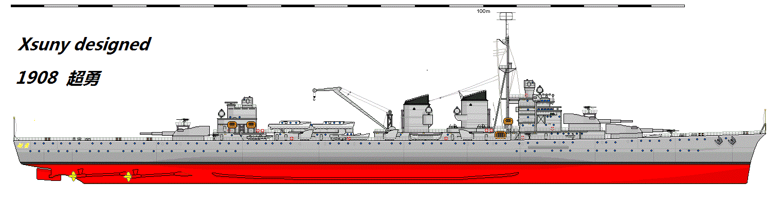

List:
1907 -- chaoyong yangwei  2
1908 -- jiyuen                  1
1910 -- pingyuen          1
1911 -- zhiyuen jingyuen  2
1912 -- jinyuen laiyuen   2
1: 超勇,扬威   1908下水
1907init BC, CHINA battleship laid down 1908
Displacement:
        15,609 t light; 16,474 t standard; 17,545 t normal; 18,401 t full load
        (565.04 ft / 557.74 ft) x 75.46 ft (Bulges 82.02 ft) x (26.12 / 27.17 ft)
        (172.22 m / 170.00 m) x 23.00 m (Bulges 25.00 m)  x (7.96 / 8.28 m)
Armament:
      6 - 12.01" / 305 mm 45.0 cal guns - 873.07lbs / 396.02kg shells, 150 per gun
          Breech loading guns in turret on barbette mounts, 1908 Model
          3 x 2-gun mounts on centreline ends, majority forward
                1 raised mount - superfiring
      12 - 5.12" / 130 mm 50.0 cal guns - 70.97lbs / 32.19kg shells, 150 per gun
          Breech loading guns in casemate mounts, 1908 Model
          12 x Single mounts on sides, evenly spread
                12 hull mounts in casemates- Limited use in heavy seas
      4 - 3.46" / 88.0 mm 50.0 cal guns - 22.00lbs / 9.98kg shells, 150 per gun
          4 x Single mounts on sides, evenly spread
                4 hull mounts in casemates- Limited use in heavy seas
      Weight of broadside 6,178 lbs / 2,802 kg
Armour:
   - Belts:                Width (max)        Length (avg)                Height (avg)
        Main:        12.0" / 305 mm        385.83 ft / 117.60 m        13.16 ft / 4.01 m
        Ends:        Unarmoured
          Main Belt covers 106% of normal length
          Main Belt inclined 5.00 degrees (positive = in)
   - Torpedo Bulkhead - Additional damage containing bulkheads:
                0.98" / 25 mm        385.83 ft / 117.60 m        26.90 ft / 8.20 m
        Beam between torpedo bulkheads 68.90 ft / 21.00 m
   - Gun armour:        Face (max)        Other gunhouse (avg)        Barbette/hoist (max)
        Main:        13.0" / 330 mm        8.66" / 220 mm                12.0" / 305 mm
        2nd:        5.12" / 130 mm              -                              -
        3rd:        0.98" / 25 mm              -                              -
   - Armoured deck - multiple decks:
        For and Aft decks: 1.97" / 50 mm
        Forecastle: 1.97" / 50 mm  Quarter deck: 1.97" / 50 mm
   - Conning towers: Forward 12.01" / 305 mm, Aft 0.00" / 0 mm
Machinery:
        Coal and oil fired boilers, steam turbines,
        Direct drive, 4 shafts, 52,097 shp / 38,864 Kw = 25.50 kts
        Range 4,500nm at 11.00 kts
        Bunker at max displacement = 1,927 tons (100% coal)
Complement:
        761 - 990
Cost:
        £1.490 million / $5.961 million
        Armament: 1,304 tons, 7.4%
           - Guns: 1,304 tons, 7.4%
        Armour: 5,655 tons, 32.2%
           - Belts: 2,548 tons, 14.5%
           - Torpedo bulkhead: 378 tons, 2.2%
           - Armament: 1,512 tons, 8.6%
           - Armour Deck: 1,042 tons, 5.9%
           - Conning Tower: 175 tons, 1.0%
        Machinery: 2,894 tons, 16.5%
        Hull, fittings & equipment: 5,756 tons, 32.8%
        Fuel, ammunition & stores: 1,936 tons, 11.0%
        Miscellaneous weights: 0 tons, 0.0%
          20,555 lbs / 9,324 Kg = 23.7 x 12.0 " / 305 mm shells or 3.4 torpedoes
        Stability (Unstable if below 1.00): 1.15
        Metacentric height 4.3 ft / 1.3 m
        Roll period: 16.7 seconds
        Steadiness        - As gun platform (Average = 50 %): 70 %
                        - Recoil effect (Restricted arc if above 1.00): 0.50
        Seaboat quality  (Average = 1.00): 1.22
Hull form characteristics:
        Hull has a flush deck,
          an extended bulbous bow and a cruiser stern
        Block coefficient (normal/deep): 0.514 / 0.518
        Length to Beam Ratio: 6.80 : 1
        'Natural speed' for length: 23.62 kts
        Power going to wave formation at top speed: 52 %
        Trim (Max stability = 0, Max steadiness = 100): 57
        Bow angle (Positive = bow angles forward): 17.00 degrees
        Stern overhang: -4.43 ft / -1.35 m
                                Fore end,         Aft end
           - Forecastle:        22.00%,  23.85 ft / 7.27 m,  20.01 ft / 6.10 m
           - Forward deck:        32.00%,  20.01 ft / 6.10 m,  16.40 ft / 5.00 m
           - Aft deck:        28.00%,  16.40 ft / 5.00 m,  16.73 ft / 5.10 m
           - Quarter deck:        18.00%,  16.73 ft / 5.10 m,  17.06 ft / 5.20 m
           - Average freeboard:                18.25 ft / 5.56 m
        Ship tends to be wet forward
        Space        - Hull below water (magazines/engines, low = better): 90.7%
                - Above water (accommodation/working, high = better): 124.0%
        Waterplane Area: 28,404 Square feet or 2,639 Square metres
        Displacement factor (Displacement / loading): 106%
        Structure weight / hull surface area: 148 lbs/sq ft or 723 Kg/sq metre
        Hull strength (Relative):
                - Cross-sectional: 0.95
                - Longitudinal: 1.58
                - Overall: 1.00
        Adequate machinery, storage, compartmentation space
        Excellent accommodation and workspace room
        Good seaboat, rides out heavy weather easily
自我点评:远洋破袭舰

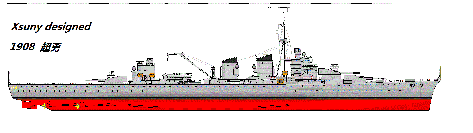

 楼主| 发表于 2012-5-2 10:07 | 显示全部楼层
2:济远
1909BB, CHINA battleship laid down 1909
Displacement:
        19,935 t light; 21,085 t standard; 22,578 t normal; 23,772 t full load
        (606.00 ft / 597.11 ft) x 78.74 ft (Bulges 85.30 ft) x (30.18 / 31.50 ft)
        (184.71 m / 182.00 m) x 24.00 m (Bulges 26.00 m)  x (9.20 / 9.60 m)
Armament:
      8 - 12.01" / 305 mm 45.0 cal guns - 873.07lbs / 396.02kg shells, 150 per gun
          Breech loading guns in turret on barbette mounts, 1909 Model
          4 x 2-gun mounts on centreline ends, evenly spread
                2 raised mounts - superfiring
      12 - 5.91" / 150 mm 50.0 cal guns - 109.02lbs / 49.45kg shells, 150 per gun
          Breech loading guns in casemate mounts, 1909 Model
      Weight of broadside 8,381 lbs / 3,801 kg
Armour:
        Main:        12.0" / 305 mm        451.44 ft / 137.60 m        13.16 ft / 4.01 m
        Ends:        Unarmoured
          Main Belt covers 116% of normal length
                1.97" / 50 mm        385.83 ft / 117.60 m        26.90 ft / 8.20 m
        Beam between torpedo bulkheads 72.18 ft / 22.00 m
        Main:        16.5" / 420 mm        9.84" / 250 mm                13.8" / 350 mm
        For and Aft decks: 2.76" / 70 mm
        Forecastle: 0.00" / 0 mm  Quarter deck: 2.76" / 70 mm
   - Conning towers: Forward 13.78" / 350 mm, Aft 0.00" / 0 mm
Machinery:
        Direct drive, 4 shafts, 63,769 shp / 47,572 Kw = 26.00 kts
        Range 7,000nm at 10.00 kts
        Bunker at max displacement = 2,688 tons (100% coal)
Complement:
        920 - 1,197
Cost:
        £1.870 million / $7.478 million
        Armament: 1,758 tons, 7.8%
           - Guns: 1,758 tons, 7.8%
        Armour: 7,756 tons, 34.4%
           - Belts: 2,920 tons, 12.9%
           - Torpedo bulkhead: 756 tons, 3.3%
           - Armament: 2,382 tons, 10.5%
           - Armour Deck: 1,461 tons, 6.5%
           - Conning Tower: 237 tons, 1.1%
        Machinery: 3,188 tons, 14.1%
        Hull, fittings & equipment: 7,232 tons, 32.0%
        Fuel, ammunition & stores: 2,643 tons, 11.7%
          25,971 lbs / 11,780 Kg = 30.0 x 12.0 " / 305 mm shells or 4.4 torpedoes
        Stability (Unstable if below 1.00): 1.03
        Metacentric height 3.7 ft / 1.1 m
        Roll period: 18.7 seconds
                        - Recoil effect (Restricted arc if above 1.00): 0.70
        Seaboat quality  (Average = 1.00): 1.20
        Block coefficient (normal/deep): 0.514 / 0.519
        Length to Beam Ratio: 7.00 : 1
        'Natural speed' for length: 24.44 kts
        Power going to wave formation at top speed: 51 %
        Trim (Max stability = 0, Max steadiness = 100): 58
        Bow angle (Positive = bow angles forward): 19.00 degrees
                                Fore end,         Aft end
           - Forecastle:        22.00%,  25.82 ft / 7.87 m,  20.05 ft / 6.11 m
           - Forward deck:        30.00%,  20.05 ft / 6.11 m,  17.75 ft / 5.41 m
           - Aft deck:        28.00%,  17.75 ft / 5.41 m,  18.41 ft / 5.61 m
           - Quarter deck:        20.00%,  18.41 ft / 5.61 m,  18.73 ft / 5.71 m
           - Average freeboard:                19.36 ft / 5.90 m
        Space        - Hull below water (magazines/engines, low = better): 83.5%
                - Above water (accommodation/working, high = better): 121.5%
        Waterplane Area: 31,731 Square feet or 2,948 Square metres
        Displacement factor (Displacement / loading): 107%
        Structure weight / hull surface area: 163 lbs/sq ft or 796 Kg/sq metre
                - Cross-sectional: 0.94
                - Longitudinal: 1.62
                - Overall: 1.00
重装甲远航程

        2nd:        6.00" / 152 mm              -                              -
        3rd:        0.50" / 13 mm              -                              -
        For and Aft decks: 3.15" / 80 mm
        Forecastle: 0.00" / 0 mm  Quarter deck: 2.95" / 75 mm
Machinery:
        Geared drive, 4 shafts, 113,456 shp / 84,638 Kw = 30.00 kts
        Range 7,800nm at 12.00 kts
        Bunker at max displacement = 4,845 tons (100% coal)
Complement:
        1,126 - 1,464
Cost:
        £2.415 million / $9.659 million
        Armament: 1,646 tons, 5.6%
           - Guns: 1,646 tons, 5.6%
        Armour: 9,041 tons, 30.6%
           - Belts: 3,602 tons, 12.2%
           - Torpedo bulkhead: 430 tons, 1.5%
           - Armament: 2,476 tons, 8.4%
           - Armour Deck: 2,249 tons, 7.6%
           - Conning Tower: 284 tons, 1.0%
        Machinery: 5,065 tons, 17.1%
        Hull, fittings & equipment: 9,694 tons, 32.8%
        Fuel, ammunition & stores: 4,089 tons, 13.8%
          35,695 lbs / 16,191 Kg = 41.2 x 12.0 " / 305 mm shells or 4.8 torpedoes
        Stability (Unstable if below 1.00): 1.09
        Metacentric height 4.6 ft / 1.4 m
        Roll period: 17.9 seconds
                        - Recoil effect (Restricted arc if above 1.00): 0.56
        Seaboat quality  (Average = 1.00): 1.21
          an extended bulbous bow and small transom stern
        Block coefficient (normal/deep): 0.528 / 0.535
        Length to Beam Ratio: 7.86 : 1
        'Natural speed' for length: 29.09 kts
        Bow angle (Positive = bow angles forward): 42.00 degrees
        Stern overhang: 8.76 ft / 2.67 m
                                Fore end,         Aft end
           - Forecastle:        22.00%,  28.87 ft / 8.80 m,  23.62 ft / 7.20 m
           - Forward deck:        28.00%,  23.62 ft / 7.20 m,  21.00 ft / 6.40 m
           - Aft deck:        30.00%,  21.00 ft / 6.40 m,  21.65 ft / 6.60 m
           - Quarter deck:        20.00%,  21.65 ft / 6.60 m,  22.31 ft / 6.80 m
           - Average freeboard:                22.70 ft / 6.92 m
        Space        - Hull below water (magazines/engines, low = better): 82.1%
                - Above water (accommodation/working, high = better): 158.9%
        Waterplane Area: 43,119 Square feet or 4,006 Square metres
        Displacement factor (Displacement / loading): 110%
        Structure weight / hull surface area: 164 lbs/sq ft or 803 Kg/sq metre
                - Cross-sectional: 0.97
                - Longitudinal: 1.32
                - Overall: 1.00
        Excellent machinery, storage, compartmentation space
高速BC

巨舰

超勇
不定期更新!!!!!!!!!!!!!!!!!
发表于 2012-5-5 20:54 | 显示全部楼层
xsuny 发表于 2012-5-5 20:53
超勇
觉得炮少了。
清明节到拉,学校一二年级学生写了贺卡给老师:“祝老师清明节快乐。”
盗-墓-贼:大哥,我不干了,我这都金盆洗手了。
盗-墓-贼头子:金盆,你们家都使上金盆啦。说,在那儿刨的。
 楼主| 发表于 2012-5-5 20:56 | 显示全部楼层
hukaikaka 发表于 2012-5-5 20:54
觉得炮少了。
能打能抗  对付无敌布鲁之流没问题
发表于 2012-5-5 21:25 | 显示全部楼层
xsuny 发表于 2012-5-5 20:56
能打能抗  对付无敌布鲁之流没问题
烟囱后面一段浪费了。,且主装过长。

 楼主| 发表于 2012-5-5 21:37 | 显示全部楼层
hukaikaka 发表于 2012-5-5 21:25
烟囱后面一段浪费了。,且主装过长。
和谐了!!!!!!!!!!!
