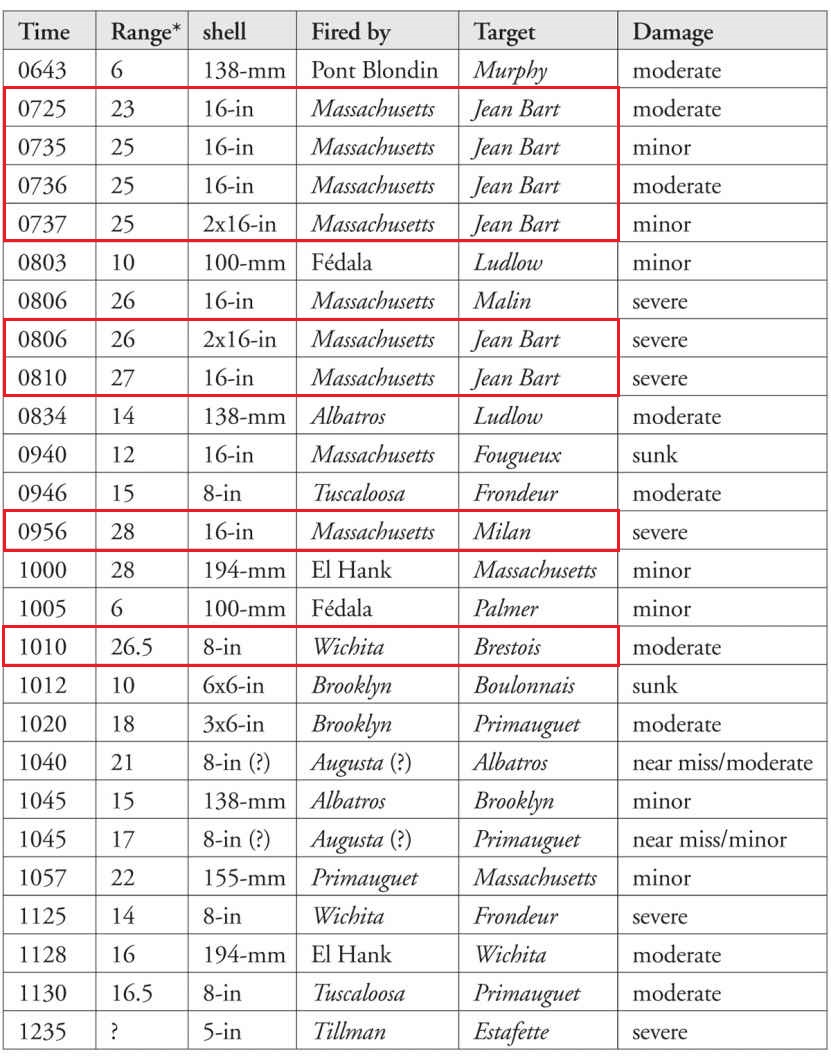

命中记录
0725至0810间,麻萨诸塞号在23,000-27,000码的距离范围内8次命中(7发直接击中,1发间接伤害)让巴尔号,这是公认的动对静最远命中距离记录。
除此之外,还有两个命中情况引起了我的注意。

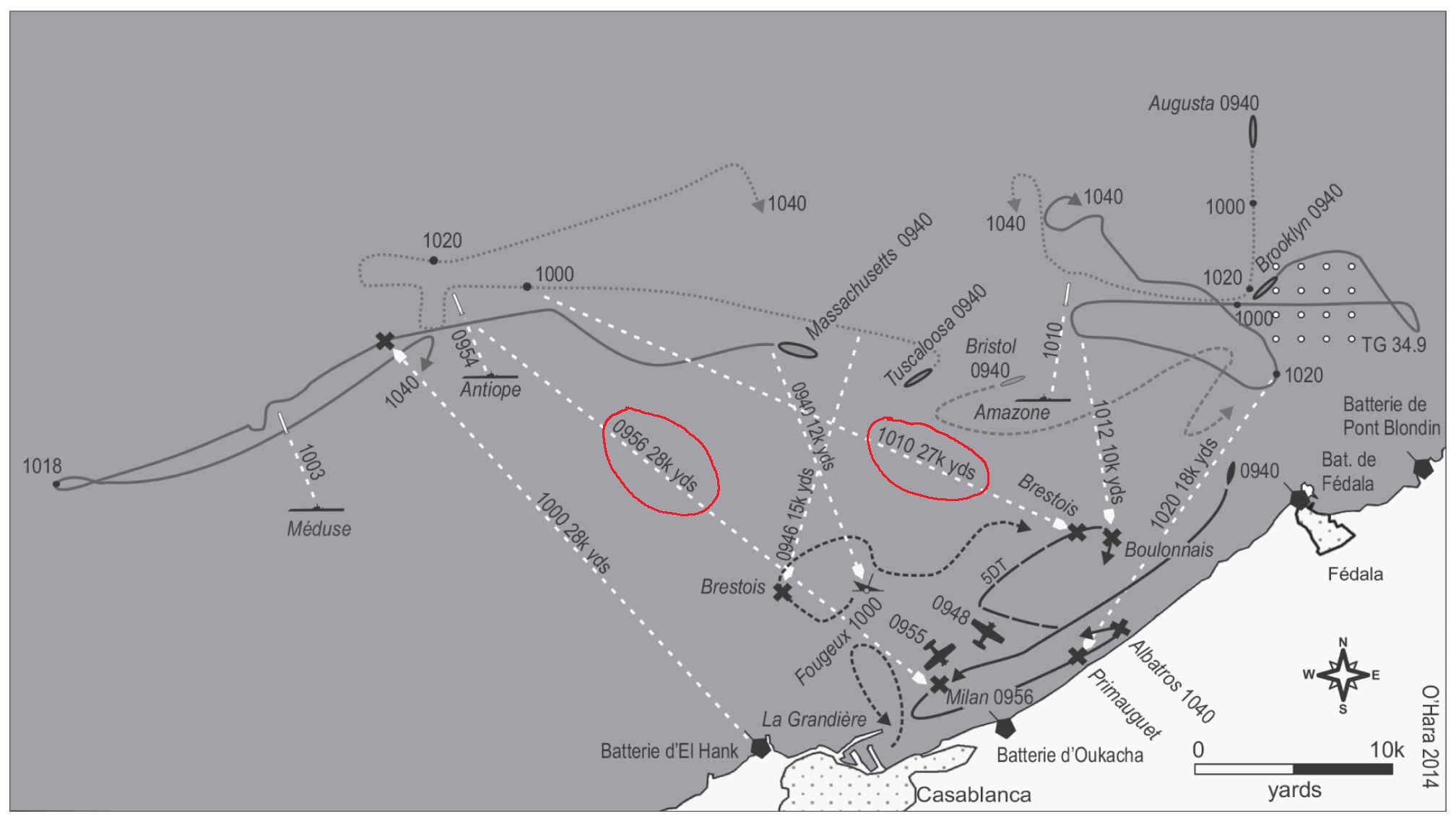

1) At 0956 Milan was twenty-seven hundred yards north-northwest of Oukacha steaming southwest when ships nearby saw her disappear in a giant green geyser. A 16-inch shell fired from the impressive distance of 28,000 yards smashed through the contre-torpilleur, exploding in the No. 2 crew’s quarter and rupturingthe hull to starboard at the waterline. Splinters wreaked havoc, destroying the radio room and cutting through the sick bay. Some penetrated all the way to the bow. Fires erupted and spread rapidly. With more than a hundred casualties Milan turned into the wind to contain the flames and slowly drifted toward Roches Noires while survivors jettisoned ammunition and torpedoes.
9时56分,麻萨诸塞号在28,000码距离上击中了Milan号超级驱逐舰。“giant green geyser”指的是麻萨诸塞号的穿甲弹内的绿色染料造成的绿色水柱。
2) At 1010, with Boulonnais and Brestois spewing clouds of white and black smoke, Chazereau ordered a torpedo attack estimating the range as 11,800 meters. However, a transmission failure prevented execution, and as the division turned to starboard, an 8-inch shell plunged into Brestois’s forecastle. This exploded in the crew’s quarters and flooded the galley and cale à vin (wine locker). This was before Augusta engaged and while Tuscaloosa was shelling La Grandière, which at 1006 had ventured from the smoke shrouding the harbor to rescue Fougueux’s men. Wichita was targeting “whichever of 3 DD’s [destroyers] or Primauguet could best be seen in the smoke” and was likely the source of this blow, which, if so, was delivered from nearly 27,000 yards.
10时10分,可能是威奇塔号在接近27,000码距离上击中了Brestois号驱逐舰。
交战态势图
这两个记录似乎分别是战列舰对驱逐舰以及巡洋舰对驱逐舰的最远动对动命中距离记录,且后者似乎也是8寸炮的最远命中记录。

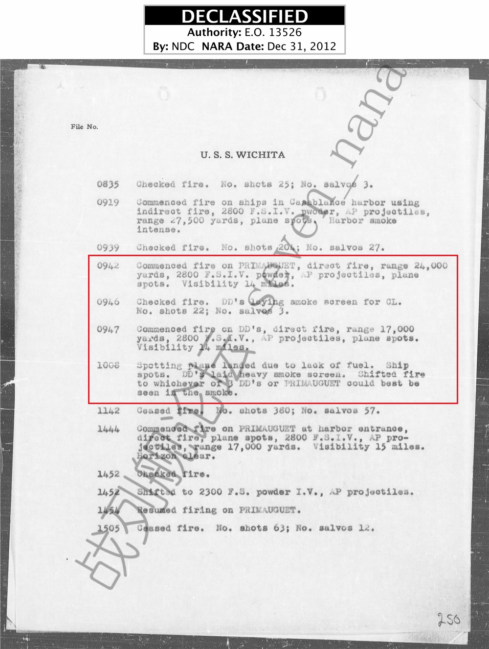

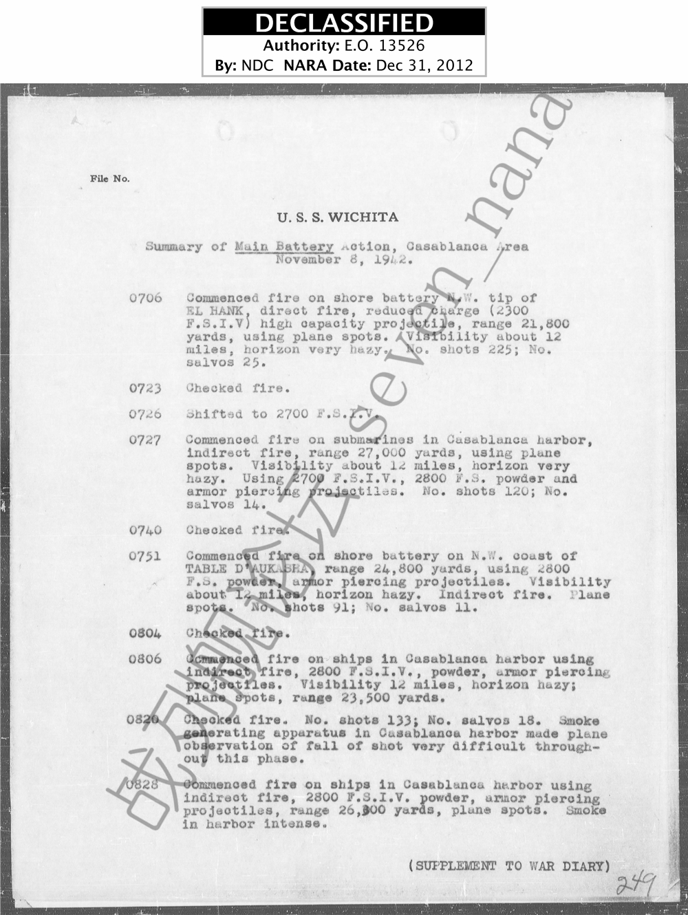

卡萨布兰卡海战的第二阶段(美舰与法国巡洋舰及驱逐舰的交战)比较复杂,美国人需保持与海岸炮台之间的距离,法国人则做了大量机动动作,并且还有拉烟雾,所以经常切换目标。
威奇塔号的主炮战斗记录
在0942之后的约半个小时内,威奇塔号多次切换了目标。
0942-0946,使用穿甲弹(弹重260磅)/全装药(初速2,800英尺/秒),向Primauguet号轻巡洋舰射击,射程24,000码,采用直接射击/空中校射的模式,能见度为14海里。0946时由于驱逐舰拉烟而停火,共发射3轮,打出22发炮弹。
0947,使用穿甲弹/全装药,向驱逐舰射击,射程17,000码,采用直接射击/空中校射的模式,能见度为14海里。
1008,校射机因燃料不足而降落,改用本舰观测,由于驱逐舰拉烟,因此向Primauguet号轻巡洋舰或3艘驱逐舰中的任何一艘在烟雾中看得最清楚的军舰射击。
对此,O'Hara的描述是“Using plane spots Wichita meanwhile lofted three salvos toward Primauguet from 24,000 yards between 0942 and 0946 before losing her target in the smoke. At 0947 Wichita turned her guns against Frondeur and L’Alcyon from 17,000 yards and thereafter engaged whatever targets were visible.”
O'Hara应该是从法方资料中确定Brestois号被击中的时间,然后采用排除法来推测出可能是威奇塔号击中该舰的。

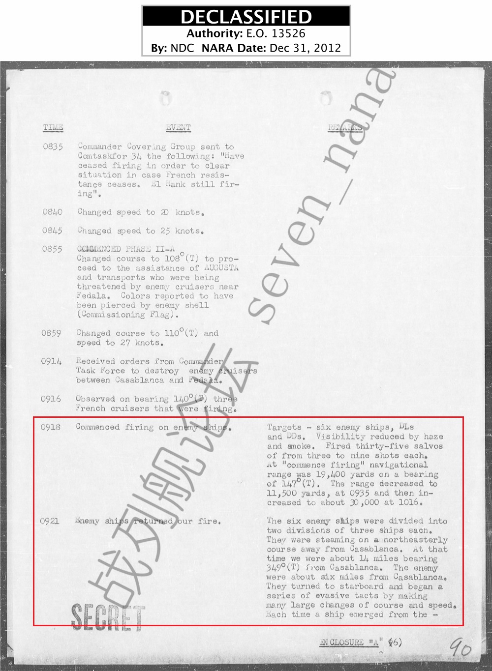

麻萨诸塞号的战报
09时18分,向敌方开火,下达开火命令时双方航海距离为19,400码,目标的真实方位是147度;09时35分时距离降低到11,500码,10时16分时则达到约30,000码。
09时21分,敌方(6艘驱逐舰和超级驱逐舰,分为2个3舰分队)开始还击,并伴随以大量规避机动。
09时51分,所有目标均消失在烟雾中,航向变更至250度(真实方位)。
09时53分,向另一个目标开火。
10时00分,被敌方炮火击中。
10时03分,发现鱼雷航迹,做出规避机动。

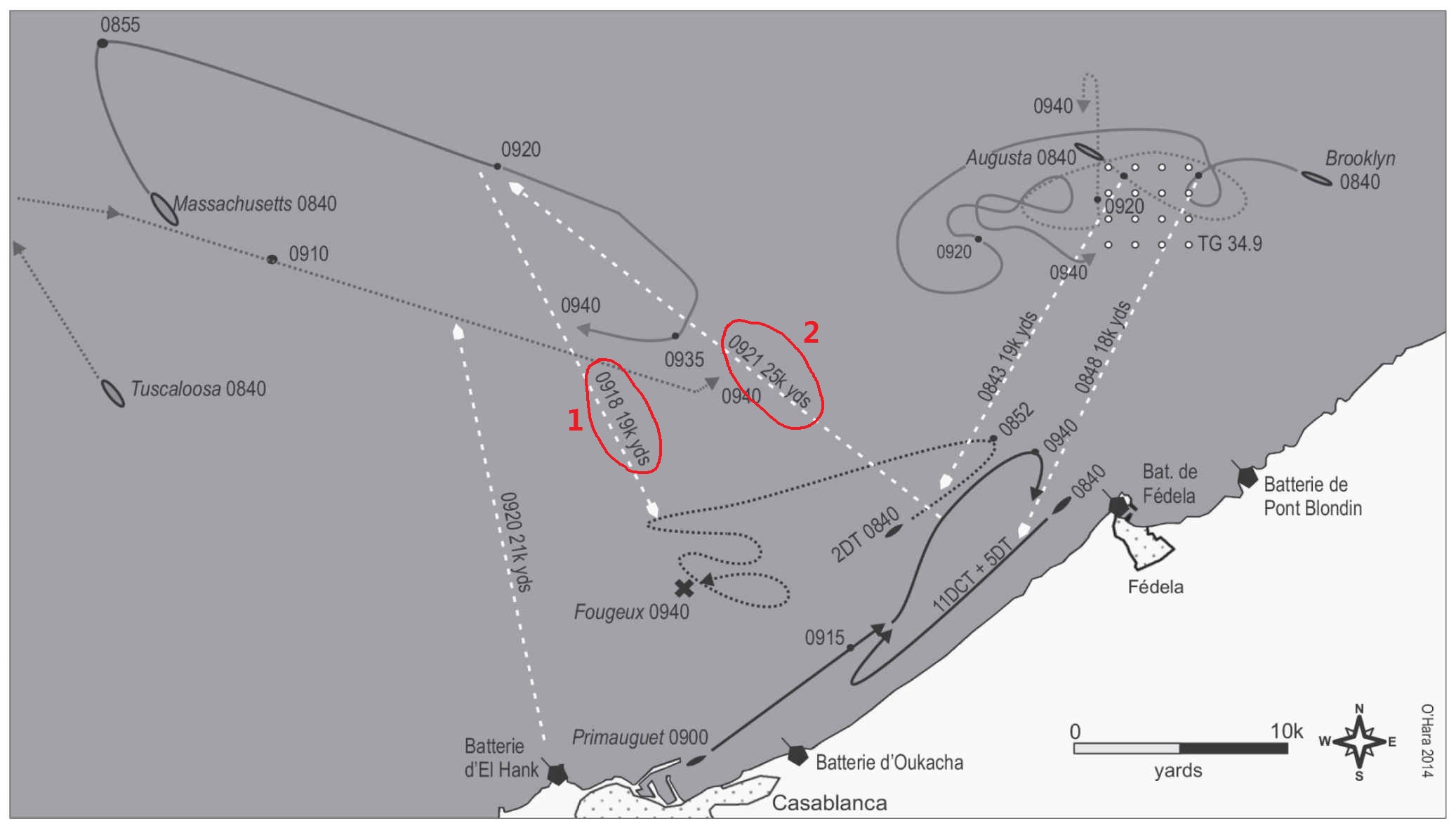

O'Hara书中的插图
0840-0940
0940-1040
1、麻萨诸塞于0918时向法舰开火。
2、法舰于0921时发起还击。
3、法舰分作两队(时间点可能是在0950左右,麻萨诸塞号战报中未记录,可能是由于烟雾的关系看不清楚)。
4、麻萨诸塞号于0951时将航向更改为250度(真实方位)。
5、麻萨诸塞号于0956时在28,000码距离上击中Milan号(麻萨诸塞号战报中的Another Target)。
6、麻萨诸塞号于1000时被法国岸炮击中。
7、麻萨诸塞号于1003时遭遇法国潜艇雷击并作出规避机动。
