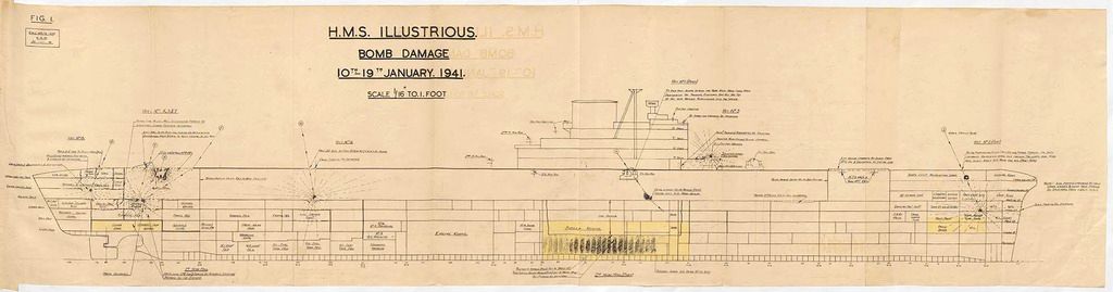

H.M.S. ILLUSTRIOUS sustained bomb damage in the Mediterranean and after temporary repairs at Malta and Alexandria, proceeded to Norfolk Navy Yard, Portsmouth Va. U.S.A.
The following account is an extract from the very full damage report prepared at the request of D.N.C. by the Manager of the Norfolk Navy Yard:-

Tactics of Attacking Aircraft.
The attacking aircraft consisted of two formations of Junkers 87 with German markings. It was difficult to count the numbers exactly but the first formation consisted of fifteen and the second of twenty to thirty aircraft. They were in a very loose and flexible formation, constantly changing their relative positions and split when engaged by long range fire It is estimated that the dive was started at about 12,000 feet and checked at 6000 to 800C feet before going into the aiming dive. Bomb release varied from about 1,500 feet in the first wave to 800 feet in the later ones. Most aircraft continued to dive after releasing their bombs and flattened out low over the water, having crossed the flight deck. At least one air-craft machine gunned the ship, The majority of the aircraft attack-ed the ship.
Most of the bombs dropped were large S.A.P. bombs of about 500 Kg. (1100 lb.) but some smaller bombs (either direct action or with very short delay) may have been used as the damage from certain hits was appreciably less than others.

PAGE 2
There were six hits and several near-misses in this attack. The probable sequence of hits with estimatedsize of bombs is as follows :-
Hit No. 1: - Probably 500 Kg. (1100 lb.). Went through leading platform of P-1 Pom-pom and struck the top of the side armour.
Hit No, 2: Probably 500 Kg. (1100 lb.). Went through the flight deck forward on the port side.
Hit No. 3: - Probably a smaller G.P. Lomb. Burst on S-2 Pom-pom.
Hit Nr. 4: - About 250 Kg. (550 lb.) Hit the after deck.
Hit No. 5: - 250 Kg, (550 lb.) or 500 Kg. (1100 ib.) Hit the star-board forward corner of the after lift well.
Hit No. 6: -001Kg. (gi00 lb.) Pierced the fight deck and burst on hangar deck.
Original type-written 500kg (1100lb) over-written in handwriting with 1000kg (2200lbs)
In addition to these six hits there were at least three very near misses.
When this very severe and brilliantly executed D/B attack was over, the ship was on fire fore and aft and the flight deck was wrecked. It was decided to head for Malt,.. The JAGUAR and HASTY were sent as screen. As the steam steering gear had been affected by this second attack, there was difficulty in checking the ship swinging.

ANNOTATION SHEET  ATTACHED TO PAGE 2
HMS ILLUSTRIOUS
Bomb Damage
10th – 19th Jan. 1941.
(Ref. D.N.C. 4B/R.92)
After examination of all available data it is considered that the size of the bomb which caused the hole in the flight deck was 1,000Kg., not 1,000 lb.
Paragraph 5, page 2 of the above report should therefore be amended to read as follows: -
Hit No. 6 : - 1,000 Kg. (2200 lb.) Pierced the flight deck and burst on hangar deck.

PAGE 3
At about 1255 the electric steering gear failed completely as did the rudder indicator from the rudder head. The 'Not Under  Control' signal was hoisted and the ship's swing checked with the engines. By 1303 the ship was again under control from the steam steering gear in the centre engine room and a course of 1000 was set, speed being worked up to 26 knots by 1313.

Summary of Damage.
Hit No.1
Probably 500 Kg. bomb which hit on the right hand feed rails of p.1 pom-pom which was trained at about Red 140. This bomb then perforated the trainer's platform and passed over the ship's side and in doing so struck the junction of two armour plates. It rebounded and fell into the water. Apparently this bomb did not explode.
Effect on Fighting Efficiency.
One pom-pom out of action.
Hit No.2. (See Photographs Nos. 1-3).
Probably 500 Kg. bomb. Struck right forward at No.10 station; passed through the recreation space port side and out through the flare  of the ship, bursting about 10' above the waterline. Splinter damage was intense causing complete peppering of the ship's side. This caused a certain amount of flooding at the forward end of the ship.
Hit No.3. (See Photographs Nos. 4 & 5).
Probably a small G.P. bomb, and was a direct hit onS.2. pom-pom which was trained Green 120. The bomb burst on impact. Deck was not perforated but was dished downwards to a maximum of about 9 in., the protective screen on the inboard side of the crane was damaged by blast. A few rounds of ammunition on loading trays were burnt. Splinters perforated the shield of S.1 porn-pom and killed a number of that gun's crew, but the damage to the gun itself was slight.
六年服役纪念章
 楼主| 发表于 2018-5-25 09:41 | 显示全部楼层
PAGE 14
Hit No. 4 - about 250 Kg. Hit the after deck.
Hit No. 5 - .250 or 500 Kg  Hit the starboard corner of the after lift well. It was not possible to discriminate between damage caused by these two hits. The entire after part of the ship from 152 to 156 frames was completely gutted down to the armour above the steering compartment. This armour remained practically intact. Apart from splinter holes the ship's side aft was undamaged. Damage was caused to the steering gear. The rudder jammed with port wheel on, and the ship circled for some time. The wheel was centred by means of the steam steering engine.
The main effect Was the complete wrecking of the after end of the ship and the damage to steering gear causing the ship to be out of control for some time,
Hit No 6, (See Photographs Nos, 11-14.)
500 Kg Struck and perforated the flight deck (3" N,C. armour) at about 131 station and 1 ft  to port of the centre line. The hole in the armour was 19" in diameter with petalled leaves turned down-wards. The armour appeared to be laminated. It is judged that the bomb only just defeated the armour. There was no general dishing of the armour and the joints were not seriously distorted The bomb detonated about 2 ft. above the hangar deck; its base struck and - perforated the armour deck at about 130 station 2' to starboard of the centre line. The explosion of the bomb dished the hangar deck between 128 and 132 stations, with a hole about 4 or 5 ft, wide, symmetrically about the centre line and between 130 and 131 stations. Below this the upper-deck-was forced down about 4". This distortion of the hangar and upper decks caused jumping of the hoists in B group and damage to the conveyor trays and this seriously impeded ammunition supply. Although the conveyor trays were full of ammunition only one round exploded.
Some splinters from this bomb or debris from ship's structure passed down through the main deck into some oil fuel tanks beneath.
The blast damage in the hangar was considerable. The after lift was distorted so that its forward end was 4 ft, down and its after end 4 ft. up (This damage may have been caused by a German aircraft which crashed into the after lift), The blast also distorted the forward lift so that at the centre line it was pushed up 1" to 4"
There was also considerable splinter damage in the hangar. All fire curtains in the hangar were destroyed by blast. They were of the roller blind type and caused considerable damage by their splinter effect.
Some serious fires were caused and hangar sprays were turned on.
六年服役纪念章
 楼主| 发表于 2018-5-25 09:42 | 显示全部楼层
PAGE 15
Hangars and both lifts out of action. Ship useless as an aircraft carrier.
Hit No.7. (See photographs No s. 6-10
A further hit, size unknown occurred in the 4th attack. It struck the after lift causing casualties among those tending wounded and putting out the fires. The damage caused by this hit was indistinguishable from, and is contained in the general description of that given above for hits 4 and 5.
Near Miss No.1
This occurred some time during the attacks at sea and was on the starboard side at the after end and caused damage, by flooding, to the electrical portion of the Steering gear.
Hit No.8.. (See Photographs Nos. 15-17).
Probably 500 Kg.. This occurred in Malta on the 16th January. The bomb struck and perforated the unarmoured portion of the flight deck just abaft station 170 and about 20 ft. to the port of the middle line. It passed through the upper gallery deck and burst just in or below the captain's cabin. Two cabins in this neighbourhood were The bomb blew a hole about 15 ft. in diameter in the hangar deck. There was considerable damage.
Near Miss No.2. (See Photographs Nos. 18 & 19).
This occurred in Malta on the 19th January. The bomb was judged to have been within a few feet of the ship's side. The bottom of the side armour was pushed in about 3". Below the armour the ship's side was set in about 5 ft. The total length of the dishing was about 75 ft. The protective bulkhead to the bulge remained watertight. Flooding outside the protective bulkhead caused a list of about 50 to port. The port boiler room which is in this vicinity was out of action due to brick work being shaken down by concussion and due to general shock damage to pipe structure. Both sliding feet of the port H.P. and L.P. turbines were fractured and there was some damage to auxiliary machinery.
