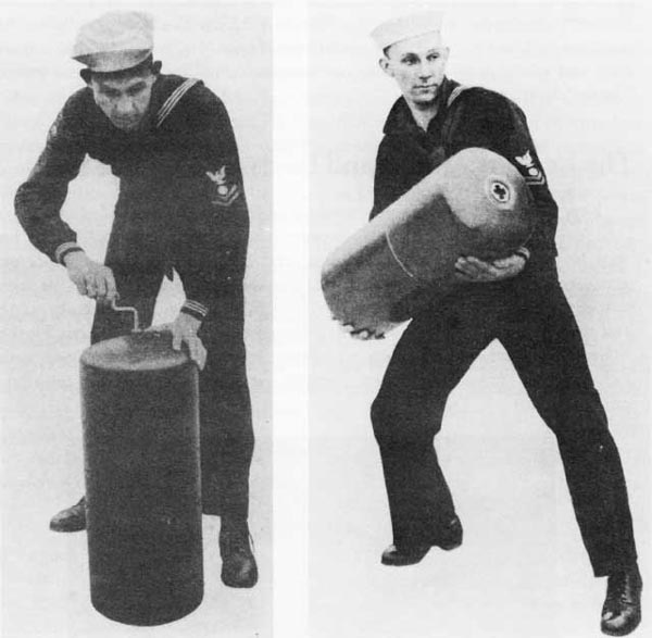

Depth Charges
Types A and B
Type A DC being set and handled by USN Sailors ca. 1917
The crank set the length of lanyard.  When the DC sank to the set depth, the lanyard triggered the charge.  The join line visible in right-hand photograph was the separation line between the float and the charge portions.  The Type B was similar, but the float section was spherical in shape.
Date Of Design 1914
Date In Service 1915
Total Weight about 50 lbs. (22.7 kg)
Explosive Charge 32.5 lbs. (14.7 kg) wet gun-cotton
Sink Rate / Terminal Velocity N/A
Settings Type A:  40 feet  (12 m)
Type B:  40 or 80 feet (12 or 24 m)
Notes:  Float and lanyard type, commonly called "ashcans."  Introduced into service in January 1915 to the Auxiliary Patrol in limited numbers.  Needed to be within 20 feet (6 m) of a U-boat in order to be effective.  There was no launching mechanism for these DC, the Captain usually picked the strongest sailor on the ship to simply toss them overboard when a U-Boat was believed to be in the immediate area.  No U-boat was damaged or sunk by these and they were rarely used.
A note on sources:  A table said to be from the 1915 Annual Report of the Torpedo School in "Depth Charge:  Royal Naval Mines, Depth Charges & Underwater Weapons 1914 - 1945" by Chris Henry says that the Type A weighed 210 lbs. (95.3 kg) and the Type B weighed 170 lbs. (77.1 kg).  Other sources disagree and, judging from the picture above showing that a single sailor could heft the Type A, my opinion is that the table shown in "Depth Charge" is in error.

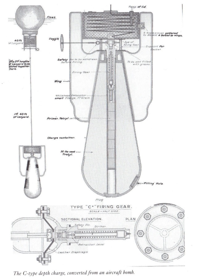

Types C and C*
Type C Aircraft Depth Charge
The Type B used a similar spherical-shaped float
Date of Design 1914
Total Weight 90 lbs. (40.8 kg)
Explosive Charge 35 lbs. (15.9 kg) amatol
Sink Rate / Terminal Velocity 10 fps (3 mps)
Settings Type C:  40 or 80 feet (12 or 24 m)
Type C*:  50 feet (15 m)
Notes:  Aircraft Depth Charge made from a modified 65 lbs. (29.5 kg) aircraft bomb.  Type C was a float and lanyard type while Type C* used a hydrostatic pistol.  No U-boat was damaged or sunk by these and they were rarely used.

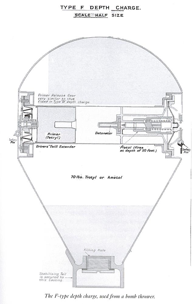

Type F
Date Of Design 1915
Total Weight N/A
Explosive Charge 70 lbs. (31.8 kg) Trotyl or Amatol
Settings 50 feet (15 m)
Notes:  Stick-type depth charge used with bomb throwers of World War I.  Stick was 48 in (122 cm) long.  Trials carried out aboard HMS Redwing in December 1915.  Said to be able to sink a submarine if exploded within 14 feet (4 m) or disable it if within 28 feet (8 m).  See below for information about bomb throwers.

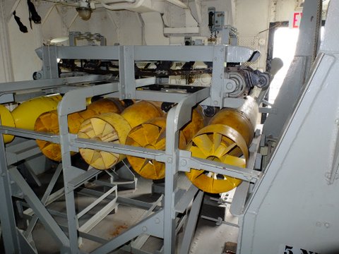

Depth Charge Racks
Standard
The first Depth Charge Rack in British service was the USN Mark I, which was developed after the USN rejected the British practice of using a sling to hold a single DC.  Developed with help from Lt.Cmdr. Ishwood, RN, deliveries of the Mark I started in April of 1918 and 250 American, British and French destroyers had them installed by the Armistice.
Mark Numbers for other British DC Racks are not available at this time.  Generally similar to USA versions, see USA ASW for further information.  Racks manufactured in 1943-44 for escort vessels held 12, 18 or 34 charges.

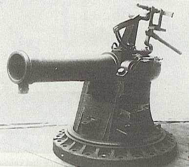

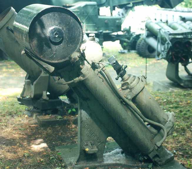

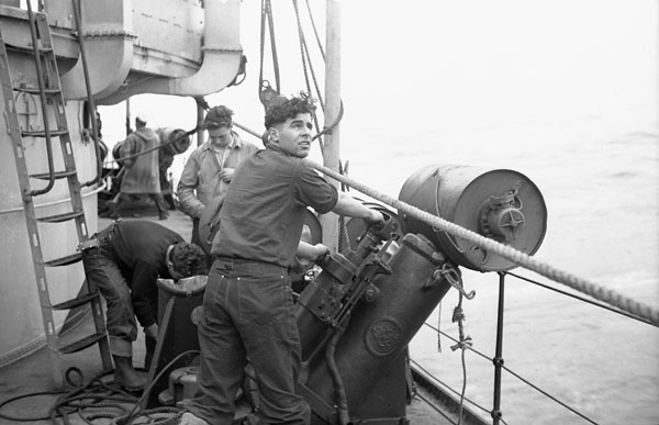

Mark I and Mark II Thornycroft
Thornycroft DCT
Exposition of Navy Museum, Gdynia
Thornycroft thrower on HMCS Sauenay on 30 October 1941
Library and Archives Canada Photograph MIKAN no. 3576681
Testing Thornycroft DCT built in New South Wales, Australia ca. 1941
Note that these are dummy DC as evidenced by the missing hydrostatic trigger mechanisms
Argus Newspaper Collection of Photographs, State Library of Victoria Image H98.105/3034
Development of this thrower started in 1916 and saw general service issue by August of 1917.  Nominal range of 40 yards (27 m) when using the Type D depth charge.  Sometimes listed as ML 9.5 in (24.1 cm) DCLT IV.
The British experienced production difficulties with this weapon and turned to the USA for help.  When examined by the USN in 1917, the conclusion was that it was over-engineered and the USN instead designed their own DCT, the famous "Y" gun.

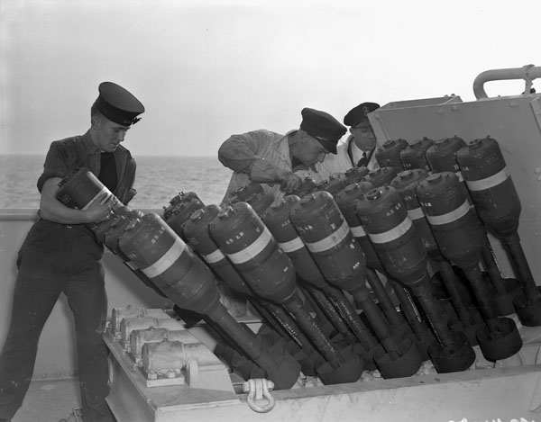

Ahead-Throwing Weapon Projectors
5" (12.7 cm), 7.5" (19 cm) and 11" (28 cm) Howitzers
7.5" (19 cm) Howitzer
First issued in June 1917, these were short-barreled, rifled howitzers that fired a projectile that looked much like a conventional artillery round.  The projectiles used a special fuze that delayed detonation for two seconds after impact, which would allow them to sink about 20 feet (6 m).  The round was designed to penetrate the outer casing of a U-Boat and then detonate on contact with the pressure hull.  The 7.5" (19 cm) howitzer fired two types of projectiles.  The first was a 100 lbs. (45 kg) projectile with a 43 lbs. (19.5 kg) charge with a maximum range of 2,100 yards (1,920 m) while the second was a 500 lbs. (227 kg) projectile with a 250 lbs. (113 kg) charge and a maximum range of 300 yards (275 m).  In June 1918, the British modified both projectiles to add a flat nose disk that caused the rounds to dive at a steeper angle.
Issued primarily to Auxiliary Patrol Vessels with 42 being equipped by October 1917 and 174 by October 1918.  The mountings had a limited traverse, probably because of concerns about the recoil blow.  Not an effective weapon and no success are recorded.

Hedgehog
Loading Hedgehop projectors on HMCS North Bay in October 1943
Library and Archives Canada Photograph MIKAN no. 3394476
This 24-spigot mortar was the first World War II ahead-throwing anti-submarine weapon in British service.  More popular and more successful with the USN than with the Royal Navy, possibly because of the former's better sonar detection practices.  Testing took place with a dummy installation on HMS Westcott in 1941 and production began in late 1942.  No U-boats were sunk with the new weapon until November 1942 and it was not really successful in the Royal Navy until 1944 when improved sonar techniques were introduced.
Projectiles had a diameter of 7 inches (18 cm) and weighed 65 lbs. (29.5 kg) with an explosive charge of 35 lbs. (15.9 kg) of Torpex.  Sinking speed was 22 to 23.5 fps (6.7 to 7.2 mps).  The projectiles were angled to give a circular pattern 40 yards (37 m) in diameter about 200 yards (183 m) ahead of a stationary ship.

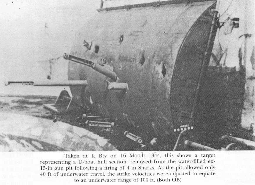

Shark Mark I, II and III
Shark test shots
Note the broken tail sections at the bottom of the hull form
Photograph and text from "Guns and Gunners at Shoeburyness"
Developed very late in the war, this projectile could be fired by any 4 inch (10.2 cm) QF gun.  Most guns used a propellant charge of 1.44 lbs. (0.65 kg) SC048, except for the Mark XVI* which used a charge of 1.63 lb (0.74).  Muzzle velocity was between 500 - 700 fps (150 - 210 mps).  The Shark projectile itself weighed a total of 96.25 lbs. (43.66 kg) including a Torpex bursting charge of 24 lbs. (10.9 kg).  Overall length was a maximum of 73.66 inches (187.1 cm) of which 53.3 in (135.9 cm) was the body and the rest finned tail.  There were two anti-ricochet nose rings and a base percussion fuze.  This weapon was intended to be fired such as to land 20 yards (18 m) short of the target submarine, striking the water at an entry angle of about 5 degrees and then continue its trajectory underwater to the hull.  It was able to pierce any side tanks and then detonate in contact with the pressure hull.  The outfit was to be 12 to 22 rounds per ship.  There were at least three Marks (I, II and III), but it is not known what the differences were between the Marks.  It is possible that the later Marks were intended for use against small coastal vessels.  Mark I entered production in early 1944 while by the end of that year Mark II and Mark III were undergoing trials.  It is not known if any of these were ever used against a U-Boat, but trials with it were thought to be "highly satisfactory."
