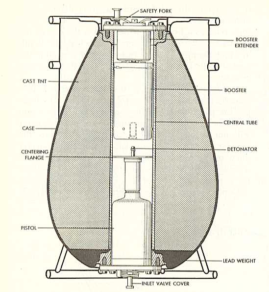

Cross-sectional view of Mark 9 Depth Charge

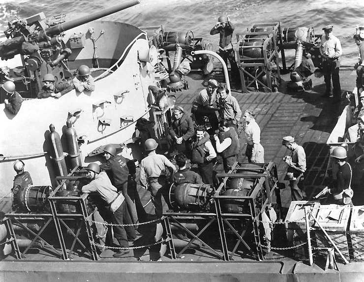

Mark 9 Depth Charges on USS Inch DE-146 on 12 June 1944
Note the K-guns located adjacent to the racks and the arbors stored under the racks.  This arrangement allowed quicker reload times, as once the arbors were loaded into the K-guns, the DCs simply had to be pushed sideways out of the rack and onto the arbors.
On 11 June 1944, USS Inch together with sister-ships USS Frost DE-144 and USS Huse DE-145 attacked and sank the German U490 and then rescued her entire crew of 80 sailors.  In the photograph above, three of these prisoners (center, two wearing life vests, one in shirtsleeves) can be seen.  Note the guard with the Thompson sub-machine gun at right.

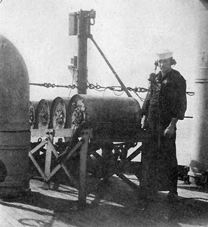

Depth Charge Racks on USS Little D-79 in 1918
4"/50 (10.2 cm) gun in the foreground
U.S. Naval Historical Center Photograph # NH 41709

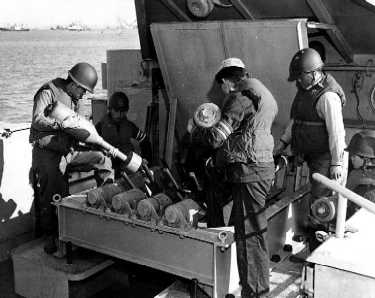

A chief petty officer prepares to fire a Y-gun in 1918
Note the arbors inserted between the depth charges and the "arms" of the gun.  These arbors detach from the depth charges after launching.
Depth charges are probably Mark 3

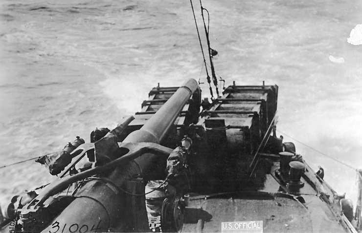

A closer look at a Y-gun on SC-267 about 1918
U.S. Naval Historical Center Photograph # NH 41995

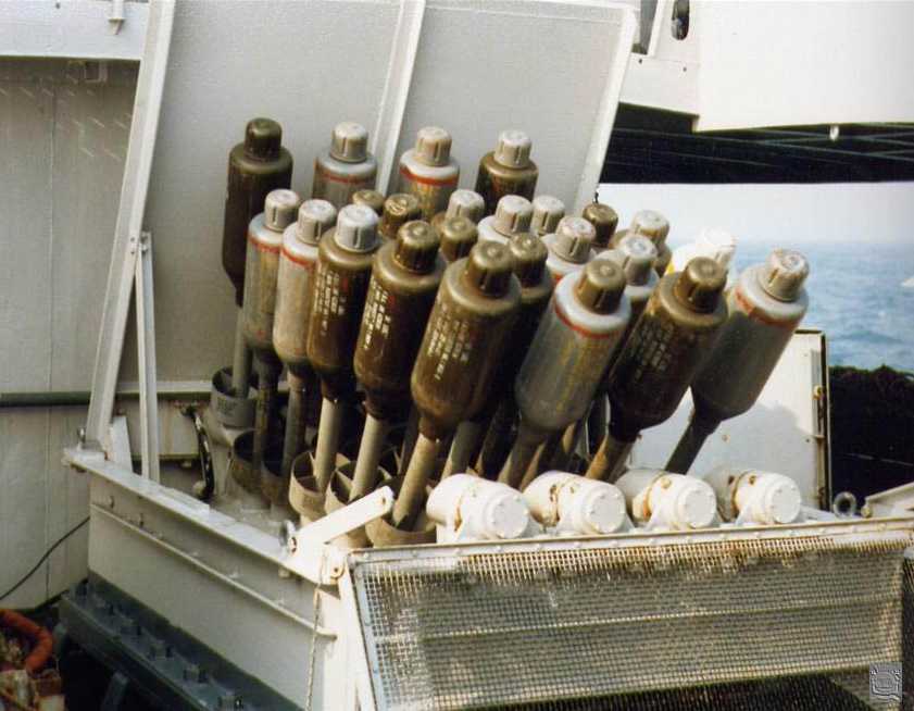

Hedgehogs in Mark 11 Launcher on a Netherlands Predator class frigate
Note that the fuze caps have not been removed

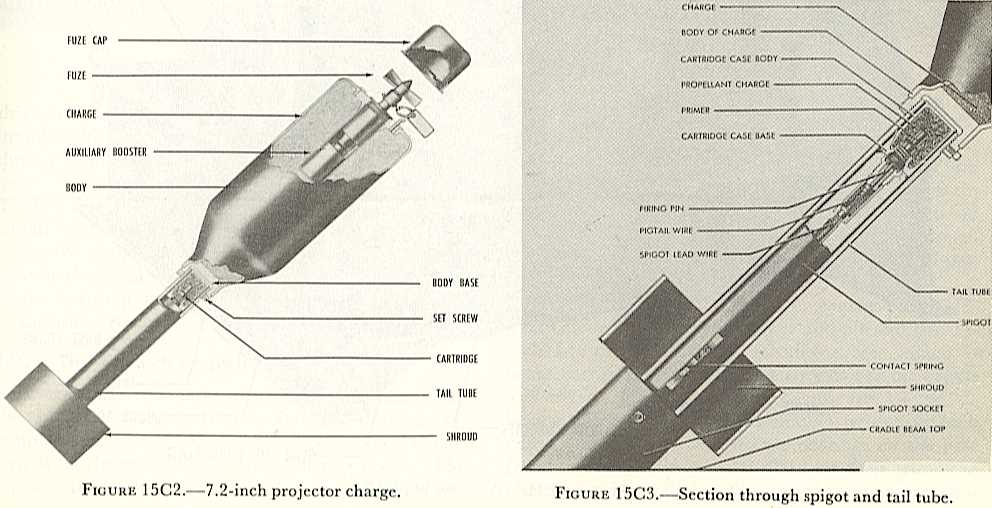

Hedgehog Projectile
Marks 10 and 11
First USN Hedgehog projectors, adapted from the British 24-spigot mortar.  More popular and more successful with the USN than with the Royal Navy, possibly because of better sonar detection practices.  Production in the USA began in late 1942 and differed from the British design in being both more rugged and more flexible in operation.  A target designation transmitter and gun train indicator, both based upon the British models, provided a greater measure of control than was available with conventional depth charges.
Projectiles were 7.2 inches (18.3 cm) in diameter and weighed 65 lbs. (29.5 kg) with an explosive charge of 35 lbs. (15.9 kg) of Torpex.  Sinking speed was 22 to 23.5 fps (6.7 to 7.2 mps).  Mark 10 fired an elliptical pattern 195 feet (59 m) in width and 168 feet (51 m) long at a range of 283 yards (259 m).  The Mark 11 fired a circular pattern 267 yards (244 m) wide at a range of 267 yards (244 m) from the firing ship.  Could be trained up to 25 degrees by tilting the firing platform.  Total weight for a dual installation and six reloads was 28,720 lbs. (13,027 kg).

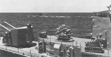

Hedgehog projectors on USS Sarsfield DD-837 in 1955
The mounting forward of the bridge is a Mark 15 and the mounting alongside the bridge is a Mark 11

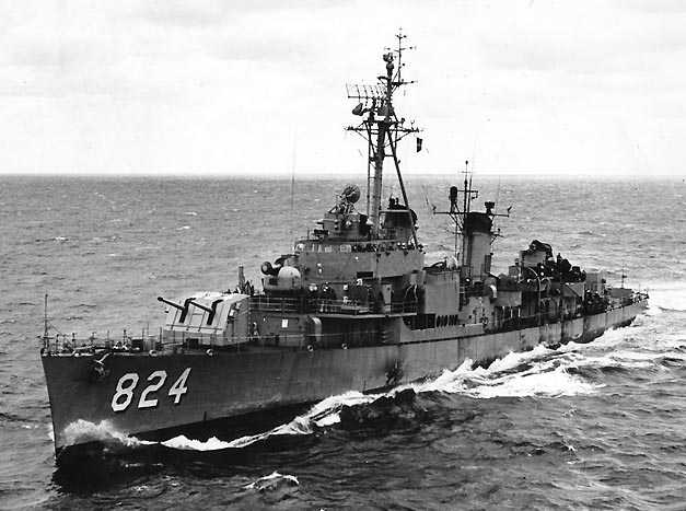

Mark 108
USS Basilone DD-824
Mark 108 Weapon Alfa launcher is just forward of the bridge
U.S. Naval Historical Center Photograph # NH 103379

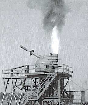

Weapon Able being test fired at Dahlgren, Virginia, ca. 1950
Note the rocket exiting the barrel and that the exhaust plume would be directly in front of the bridge of the launching ship
Weapon Alfa
Originally known as Weapon Able, this was later known as Weapon Alfa or Alpha.  The original Mark 108 launcher was based on the twin 40 mm Bofors gun mount and weighed 22,760 lbs. (10,324 kg).  The later, purpose-built mounting had a weight of 25,240 lbs. (11,450 kg).  Total weight of the latter mounting with 72 rounds was 85,000 lbs. (38,560 kg).  Weapon Alfa could fire 12 rounds per minute and held 22 rounds in a ready-service ring.  Train rate was 30 degrees per second, maximum elevation was 85 degrees.

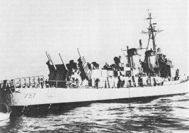

Mark 110
USS De Haven DD-727 about 1958
Mark 110 RAT Launcher on aft 5"/38 (12.7 cm) mount
Rocket Assisted Torpedo (RAT) launcher.  Installed in pairs on twin 5"/38 (12.7 cm) gun-houses, one on each side.  There was to have been an alternative version for ships that did not have 5" (12.7 cm) gun-houses.  For specifications on RAT, see USN ASW Missile section of Naval Weapons.  RAT was superseded by ASROC.
