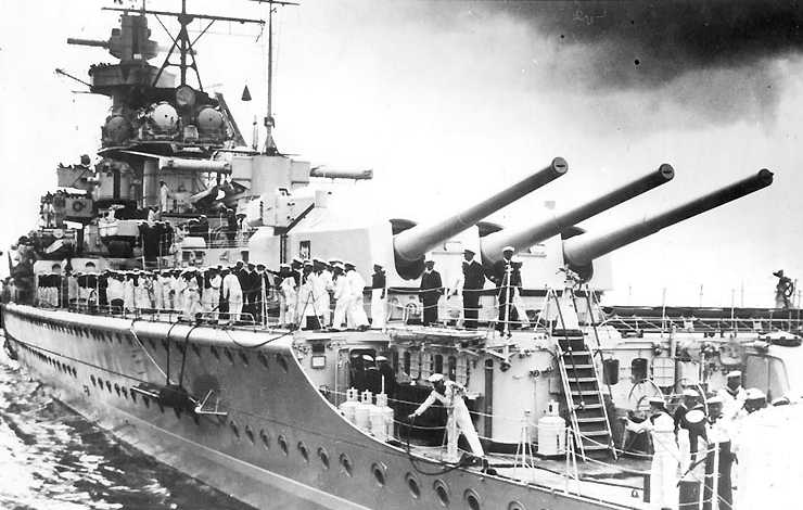

Stern 28 cm/52 Turret on Admiral Graf Spee in mid-1939
U.S. Naval Historical Center Photograph # NH 80897
