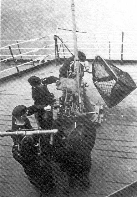

2 cm/65 C30 showing 20-round magazine
The sailor at the lower left is holding a rangefinder.  The bag is to catch expended shell casings.
Photograph courtesy of Peter Lienau
