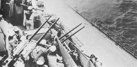

3.7 cm/83 SK C/30 guns on Bismarck

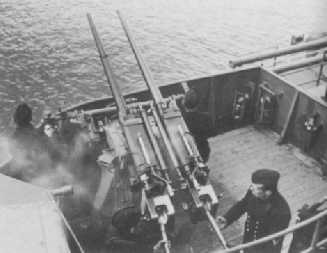

3.7 cm/83 SK C/30 practice shoot aboard Heavy Cruiser Prinz Eugen
Note the hand loading of individual rounds

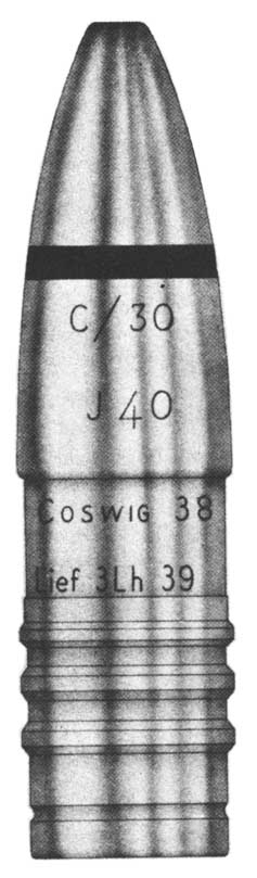

Spr.gr. HE-T Projectile
"Coswig" is a manufacturing town in Germany
