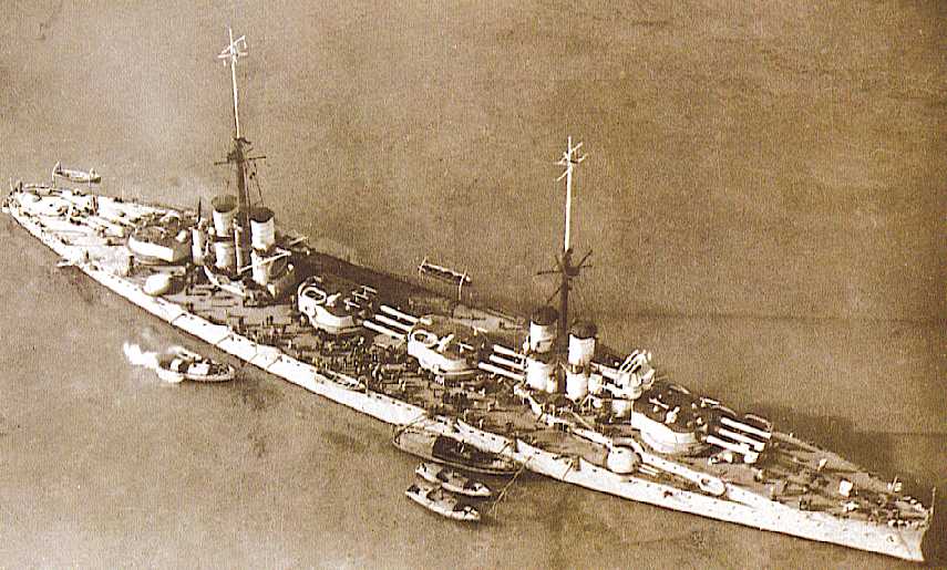

Battleship Dante Alighieri
This was the first ship to carry large caliber guns in triple turrets
Note the arrangement of funnels
Photograph by Malandrini Ferrucclo, Alinari Archives-Florence
