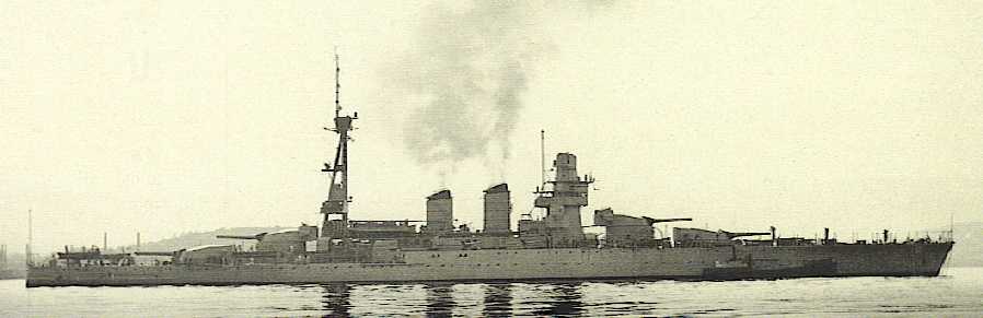

Battleship Andrea Doria in 1940
Battleship Conte di Cavour pre-war
Photograph by De Pinto Donazione, Alinari Archives-Florence
