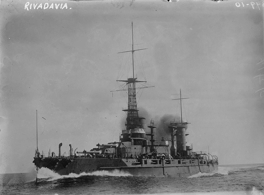

Argentine Battleship Rivadavia
Bain News Service Photograph
Library of Congress Photograph ID LC-DIG-ggbain-14781

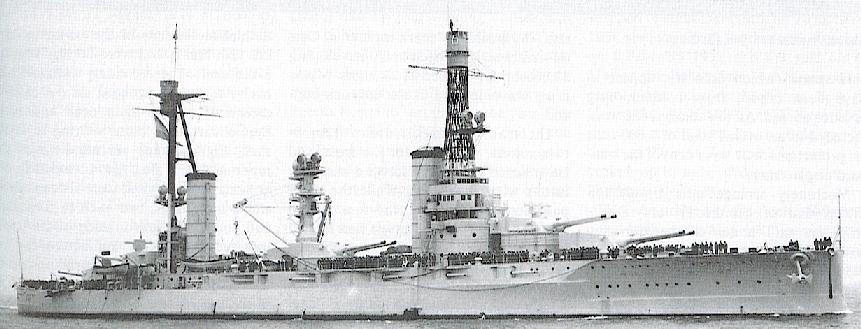

Argentine Moreno off Portsmouth in July 1937
Note rangefinders atop superfiring turrets

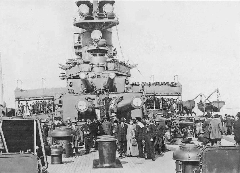

Bow turrets of Moreno circa 1930
Note 6"/50 (15.2 cm) gun at right
Photograph courtesy of Georg v. Rauch

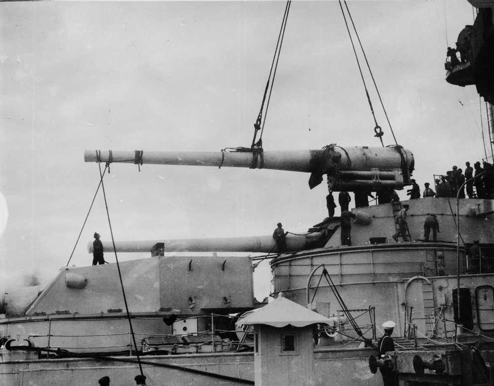

12" gun being installed aboard Moreno
Photograph from the collection of Carlos Mey and used here by his kind permission
