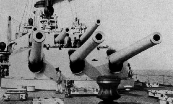

Stern Mounts of Viribus Unitis

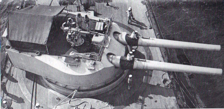

Good view of turret on a Radetzky class battleship
Note the tent for the 7 cm gunners

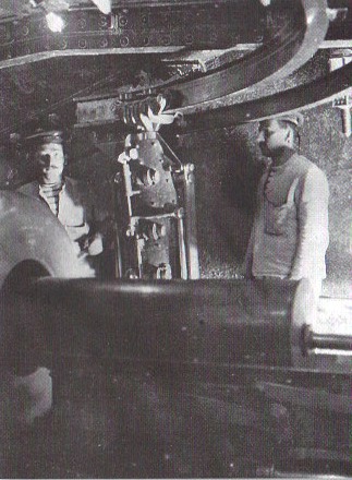

Breech of one of the 30.5 cm guns on Prinz Eugen
Note the open breech mechanism
Photograph from Austrian State National Archives

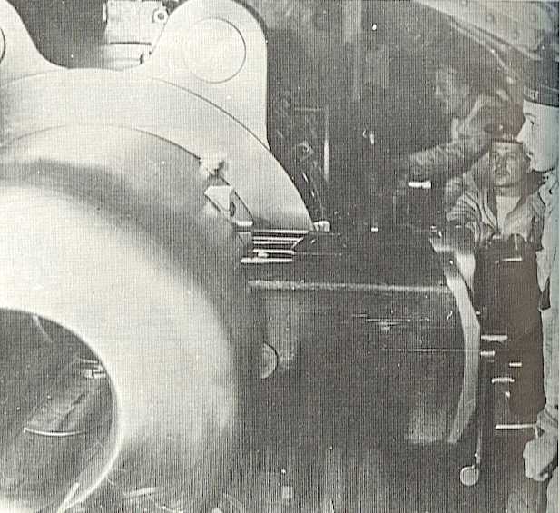

30.5 cm cartridge being rammed
