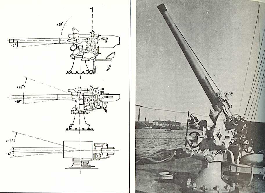

Left:  Sketches of 7 cm gun in anti-airship, anti-torpedo boat and casemate mountings
Right:  Anti-airship mounting on a cruiser
Collection Pavlik photograph

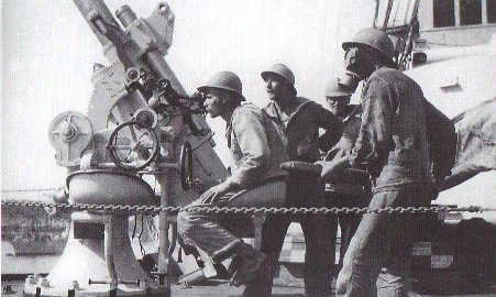

7 cm being used as an AA weapon
Note the sailor with the projectile and gas mask at right
