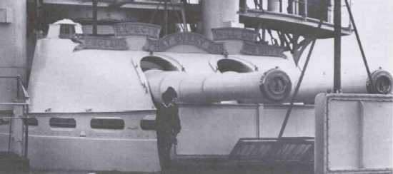

After 10-in (25.4 cm) guns on HMS Renown
Legend on top of shield is "England expects that every man will do his duty" [Lord Nelson]
This is an open-backed gun shield.  Note the depression rail on top of the barbette, which kept the guns from firing into the ship's structure.
IWM Photograph
