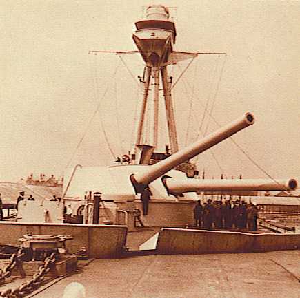

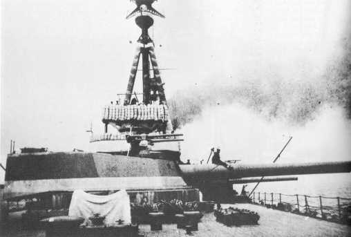

Unidentified Abercrombie Class Monitor
Note 4" (10.2 cm) secondary guns on top of turret
IWM Photograph (CPL)
HMS Havelock being toured by journalists in May 1916
Following the Lowestoft Raid by German battlecruisers in April 1916, Havelock was moored in the Hamilton Dock at Lowestoft
