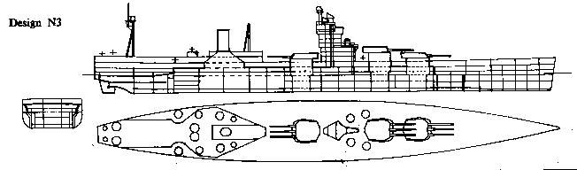

N3 Battleship Design Sketch from "British Battleships of World War Two"
The crosses and circles represent 4.7" (12 cm) and 2-pdr. AA guns
