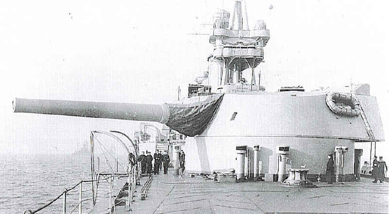

A total of three 18" (45.7 cm) guns were built by the Armstrong Works at Elswick, the only manufacturer capable of making such large weapons. These guns were designated as "15 inch B" during their design and construction in an effort to hide their true size. In many respects the construction of these guns resembled that for the 15"/42 (38.1 cm) Mark I and the mountings were essentially 15" (38.1) Mark I turrets adapted to take a single 18" (45.7 cm) rifle. These were the largest guns ever fitted to a warship with the exception of the 46 cm (18.1") guns built twenty years later for the Japanese Yamato class battleships. Only one 18"/40 (45.7 cm) gun was actually installed on HMS Furious and gun trials with it were carried out in July 1917. These showed that this lightly-built ship could not handle the overpressures generated and so the gun was removed and Furious was converted to an aircraft carrier. All three guns were then to be used on monitors in fixed mountings. Two of these monitors saw service during World War I and one of these, HMS General Wolfe, engaged a railroad bridge at Snaeskerke, four miles (6.5 km) south of Ostende, Belgium, on 28th September 1918 at a range of 36,000 yards (32,920 m), the longest range at which a Royal Navy vessel has ever fired upon an enemy. General Wolfe fired a total of 81 rounds against enemy targets while Lord Clive fired an additional four rounds. The war ended before the third monitor, Prince Eugen, could be converted. After the monitors were scrapped following the end of the war, their guns were used for various testing purposes. Gun number 1 was used at Silloth for cordite proofing tests in 1920 and afterwards converted to a 16" (40.6 cm) design between 1921 and 1924 for use as a prototype for the 16"/45 (40.6 cm) Mark I guns destined for the Nelson class. It was then used for various trials until 1942 when it was sent to Woolwich where it remained until scrapped in 1947. The other two weapons were also used for experimental testing, one at Shoeburyness and one at Yantlet on Grain Island. These two guns were sold for scrap in 1933. It is a myth that any of these weapons were used as part of the defenses at Singapore. As mentioned above, these were wire wound guns whose construction generally resembled that of the 15"/42 (38.1 cm) Mark I but with a relatively small breech ring. Construction consisted of inner A tube, A tube, wire-winding, B tube, jacket, shrunk on collar and breech ring. Over 200 miles (325 km) of 0.25 x 0.06 in (0.635 x 1.52 cm) of high-tensile steel wire was used. The Welin breech block used on these guns differed in that the Vicker's "pure couple" mechanism used on the 15" (38.1 cm) gun was replaced with the Elswick short arm mechanism for reasons of reducing "slam" as the breech closed. In this design, the breech screw withdrew through the carrier, which complicated the locking action. However, this mechanism was fast-acting, with about three seconds being needed to open or close the breech. |
![]() Aft turret of HMS Furious in 1917
