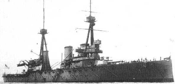

HMS Invincible
Two of the 4"/40 (10.2 cm) guns are on top of "A" turret
