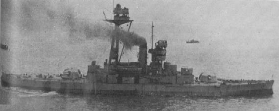

HMS Gorgon in 1918
Note the high mainmast and that it was in the path of the funnel gases
IWM (CPL) Photograph
