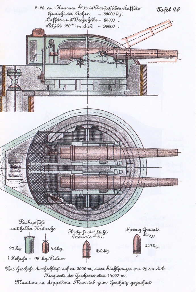

Sketch of 28 cm/35
Note that the guns could only be loaded when the gunhouse was trained to 0 degrees

Designation Two-gun turrets
   Kurfürst Friedrich Wilhelm (1):  Drh.L. C/92
Elevation Drh.L. C/92:  -5 / +25 degrees
Loading Angle N/A
Note:  This mounting was used amidships.  Bow and stern guns were 28 cm/40 SK L/40.  Guns may have been required to train to 0 degrees in order to load.
