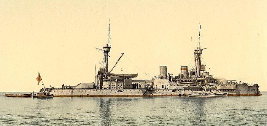

Kurfürst Friedrich Wilhelm at Helgoland, Germany
28 cm/40 guns are in bow and stern mountings
Midships turret carried 28 cm/35 guns
Library of Congress Photograph ID LC-DIG-ppmsca-00589

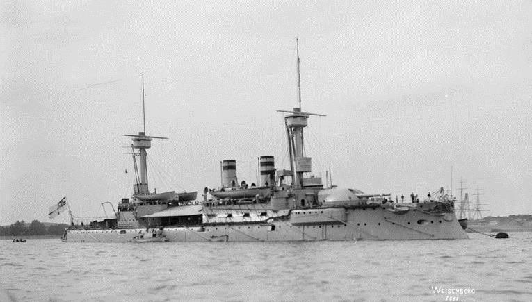

Pre-dreadnought Weissenberg
Note that the name is mis-spelled on the photograph
IWM photograph Q 41287
