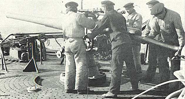

Used on cruisers and gunboats of the early 1900s.  Some of these guns still served during World War II in coastal batteries and on small combatants.  Used a horizontally sliding breech mechanism.
10.5 cm/40 SK L/40 on Minesuchboot during World War I
