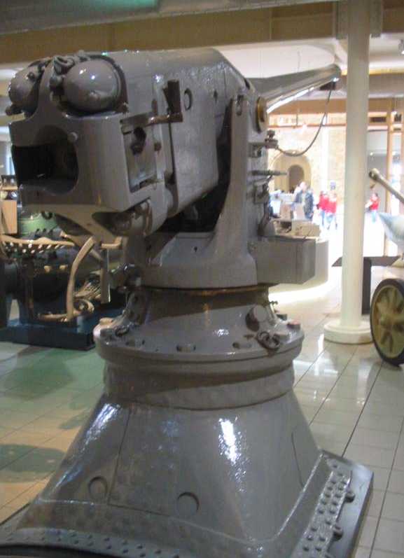

10.5 cm Ubts.u.Tbts.K. L/45 from U98 now at the Imperial War Museum in London, UK
Note the horizontally sliding breech block and top-mounted recoil cylinders

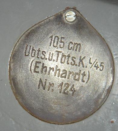

Identity Plate on above weapon
