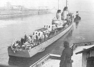

A type T23/T24 class Torpedo Boat

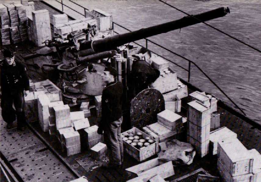

10.5 cm/45 SK C/32 on an unidentified Type IX U-boat
