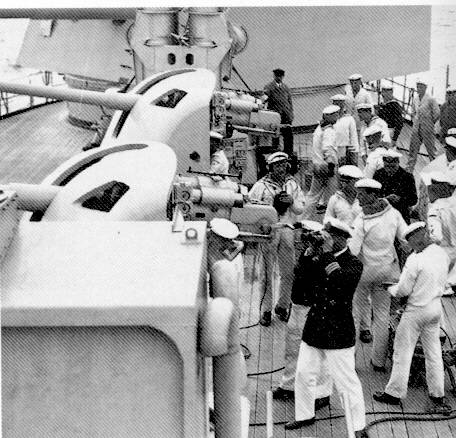

Two 8.8cm/45 FLAK L/45, probably on light cruiser Königsberg during the 1920s

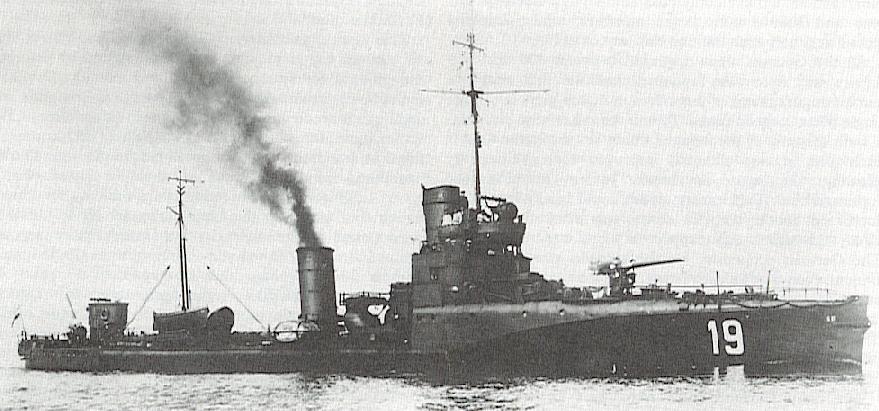

Torpedo Boat S19 sometime after 1916 when she had been rearmed with 8.8 cm/45 guns

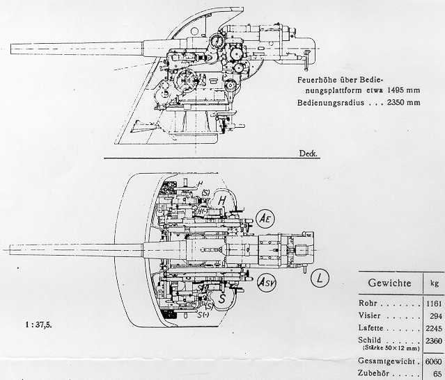

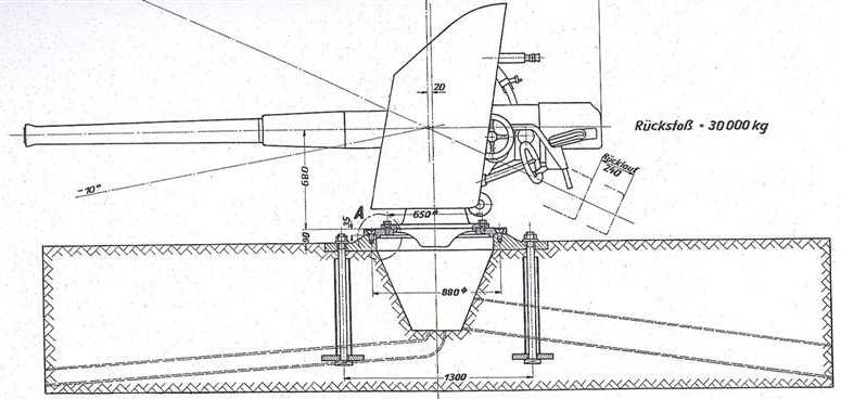

Sketch of 8.8 cm/45 SK L/45
8.8 cm/45 SK L/45 in MPL C/06 Mounting
This sketch appears to show an adaptation for land mountings
